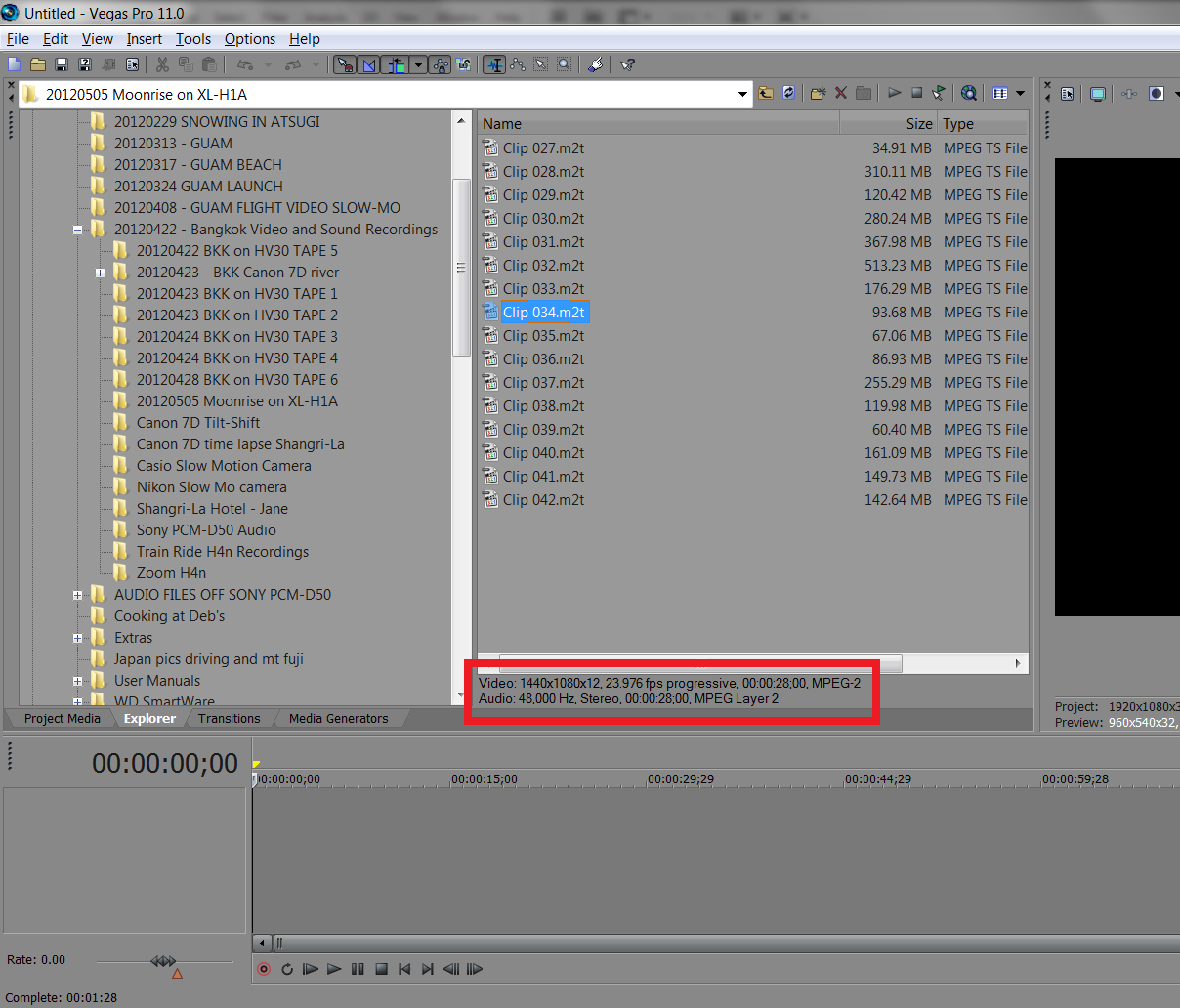

Jeff,
I had this happen recently, not a screw-up, just wanted to shoot the same scene with 60i, 24p, 30p. So I had a mess of formats on the same tape. I opened Vegas and also my file viewer program (FreeCommander) and had them side-by-side on the screen. In the "Explorer" window of Vegas, I opened up the capture folder and scrolled down the list of clips. Each clip I cursor over, brings up the file info at the bottom of the listing, such as clip length and frame rate. Most of my clips were shot in 60i, so each time I got to a 24p or 30p clip, I moved over to my file viewer program and moved that file into a folder named "24P" or "30P". Might be a faster method, but at least I didn't have to drop them on the timeline to examine the properties.
HTH,
Mark
PS - If you put all your files on the timeline, they will then appear in the Project Media window of Vegas, which is like a database and one of the fields is frame rate, but I don't know if you can sort by it, would seem so, just that I haven't tried it.
