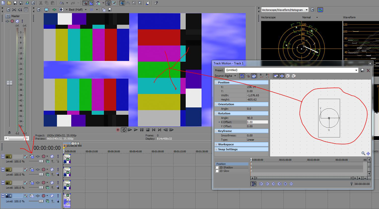

Use the Track Motion tool
You wont believe how easy it is

thanks Gerald. I spent a good amount of time trying and I got very close to understanding how to make that last clip above( "Intersections")
I guess I wasn't familiar with the concept of nesting projects to a new track, and then using track motion.
Still,I don't quite understand yet how to replicate the final few seconds, where all the screens then rotate showing the credits, that's really well done.
still not 100% familiar with the differences in why you would use track motion vs pan and crop but slowly getting there....
