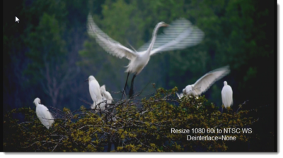

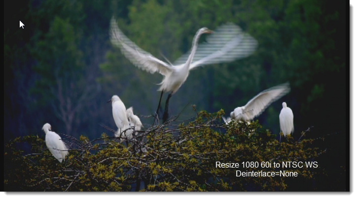

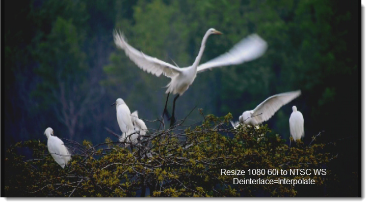

Don't believe it? Run a test. Here I've rendered 1080 60i footage to NTSC WideScreen. First, with Deinterlace=None, next with Deinterlace=Interpolate.

Scaling of interlaced source to interlaced output is done using the same interlace aware scaling algorithm when deinterlace mode is set to either blend or interpolate fields. The only difference between blend and interpolate fields is when the source is interlaced and the output is progressive.

If you scale interlaced footage with deinterlace method set to "none" it will result in visible interlace artifacts. As mentioned above there are very, very rare cases where it makes sense to use "none". Another one (in addition to the one mentioned above) is when you use a 3rd party plug-in for deinterlacing. I'm not aware of any other cases where it would be useful to leave the standard setting of "blend" or "interpolate".
