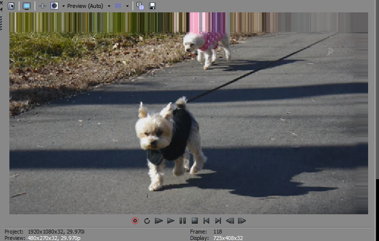

[Update] Forget working to get me a discount. A simple test of a short video I have produced some unacceptable modification to my footage. Attached is a screen shot of some color bars at the top of a frame. This, as well as something similar at the bottom of the frame, showed up for 15 or so frames near the middle of my 34 second clip. I confirmed these bars were not in the source file nor did they show up in the Preview window when I turned off the Stabilizer plug in.
Guess I'll look at Mercalli or do without.

Those are not color bars. That is where it's stretching the footage to fill the frame. That can be eliminated by changing the Border Fill options. You should change the "Method" and "Crop" to eliminate that from happening.

Re: NewBlueFX Stabilizer
Color bars was the only way I could think to describe it. I know they are not real "color bars".
In any case, if I crop won't I lose part of the frame? As you can see, that would crop out part of the subject in the frame. I don't want to do that. Or am I misunderstanding?

Well... you've already lost part of the frame. The bottom of the frame has been lost which is why you're getting what you see on the top. This is necessary to stabilize - the frame must be "moved" to keep the image steady. Try the other border options and use a small crop value of, say, 20% and see what you think of the results.

Edward is right. To put this another way, there ain't no such thing as a free lunch! And, with apologies to Red Giant Software, there really aren't any magic bullets, either. For post stabilization, that means you lose something... typically the frame edges.
The method that all post stabilizers use is to zoom in on the footage and try to identify objects in the frame that should be kept steady. Then, the stabilizer pans and tilts around to do so. Some more successful than others.
Think of it this way - if you project your shaky footage on a screen, you could then shoot it with a camera, doing the reverse of the original moves to stabilize it in your new recording. However, then you have the edges of the screen to deal with, which start to show up as you pan and tilt. You could show them, or, more commonly, zoom in a bit to hide them.
It's all a compromise of your original footage, that's the nature of the beast.
