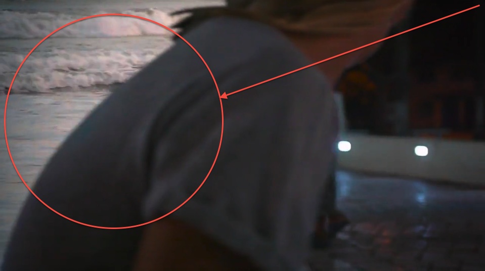

Put the clip of the girl in white shirt on track one,
Go into pan crop, select the mask tool and draw a mask along her back to remove whats to the left of her back,
Put your next clip on track 2, and roughly line up your In point to where you want track one's Out point.
Go into Track Motion of Track 1 and key frame the girls track to move to the right until gone. It works well here because the track motion just increases the camera pan.
Fine tune and you are done.
Hint, use a bit of Feather on your Mask to make it look more natural.

Chris, You would need a mask to make it a bit more than a simple "Push". See pic-
Jeff, Always ask questions :) I for one can remember a very short time ago that it was me asking the sometimes simple questions and all the good people here helped me no end.
