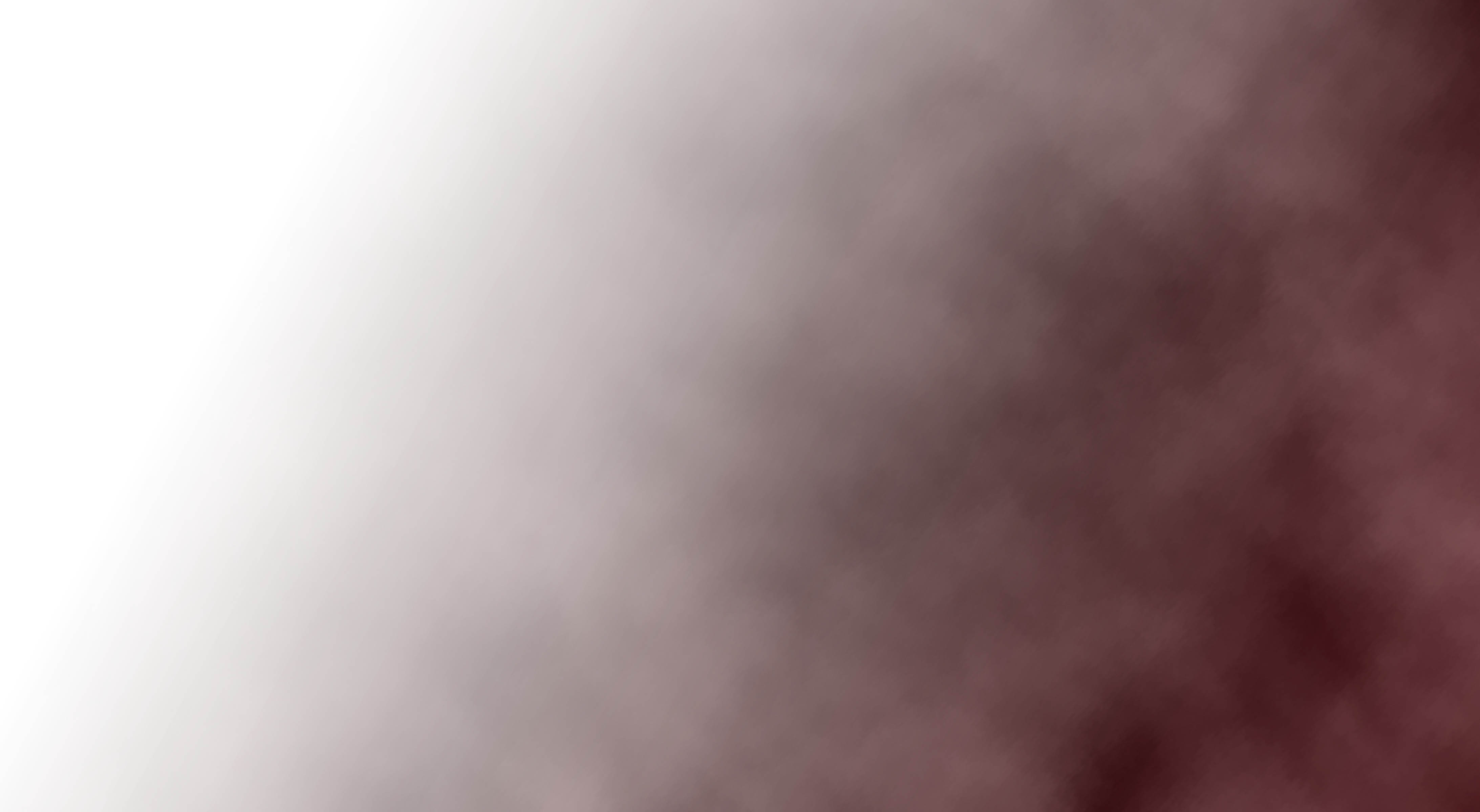

When I refer to 'clouds' they're not 'clouds in the sky' but a Photoshop generated cloud background as per Create A Portrait Studio Background - Photoshop Tutorial
I'm putting a gradient across it so I can have it light at the left hand side for illustrations I'm going to use...and then I put a colour gradient across it to add zing to it...well something more than grey anyway...see below. I will be in front of the coloured area. Both the clouds and the colour will change over perhaps 10>15 mins, and with some of the sessions which are longer ... 15>25 mins...I may put another cloud and colour at the midway point.
