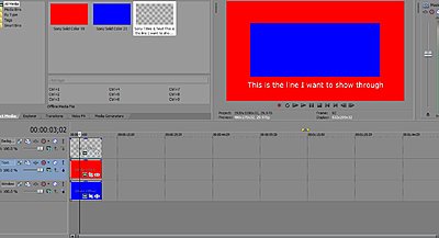

Track one is the background and has a mask that allows track 3 to show through as desired.
I need my title track 2 to display text on top of the background in a different area than the first mask.
I've attached a veg file as an example.
Thank you.

If all you want is for the text to show, just put it on top of the other two.

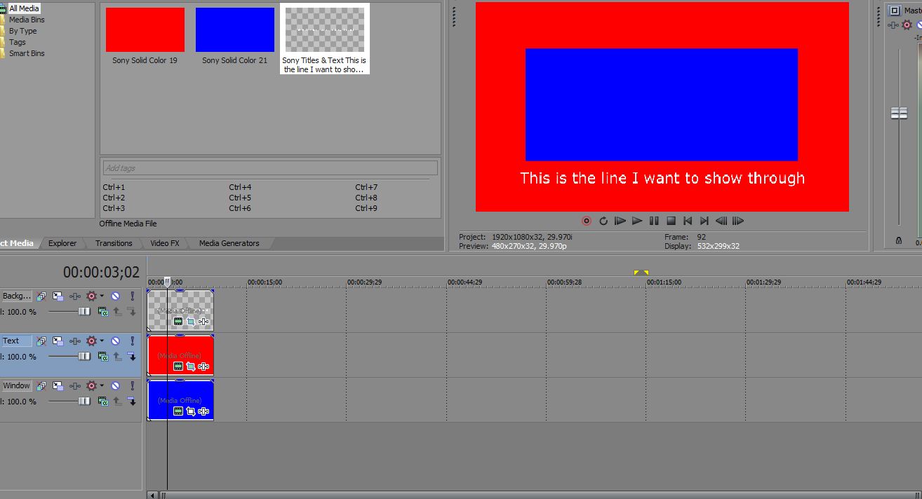

Here is what David is saying from your example. (See pic below)
Chris J. Barcellos

OMG, I can't believe I missed that! I swear I tried every combination and thought that was the first I tried. LOL
Well glad this was an easy one to figure out.
Thanks everyone!
