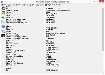

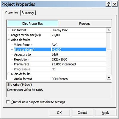

Jack, try it yourself (picture must contain sufficient detail and movement):

I know the bitrate can be obtained, but see the 2nd screenshot where it says "Main @ 4.1?" With Sony AVC, you can choose High profile.

The only significant difference is that 8×8 intra prediction size not alowed in main profile. I don't know, use Sony AVC it ot not in hight profile.
