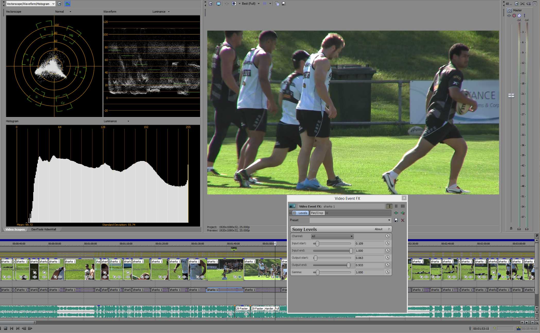

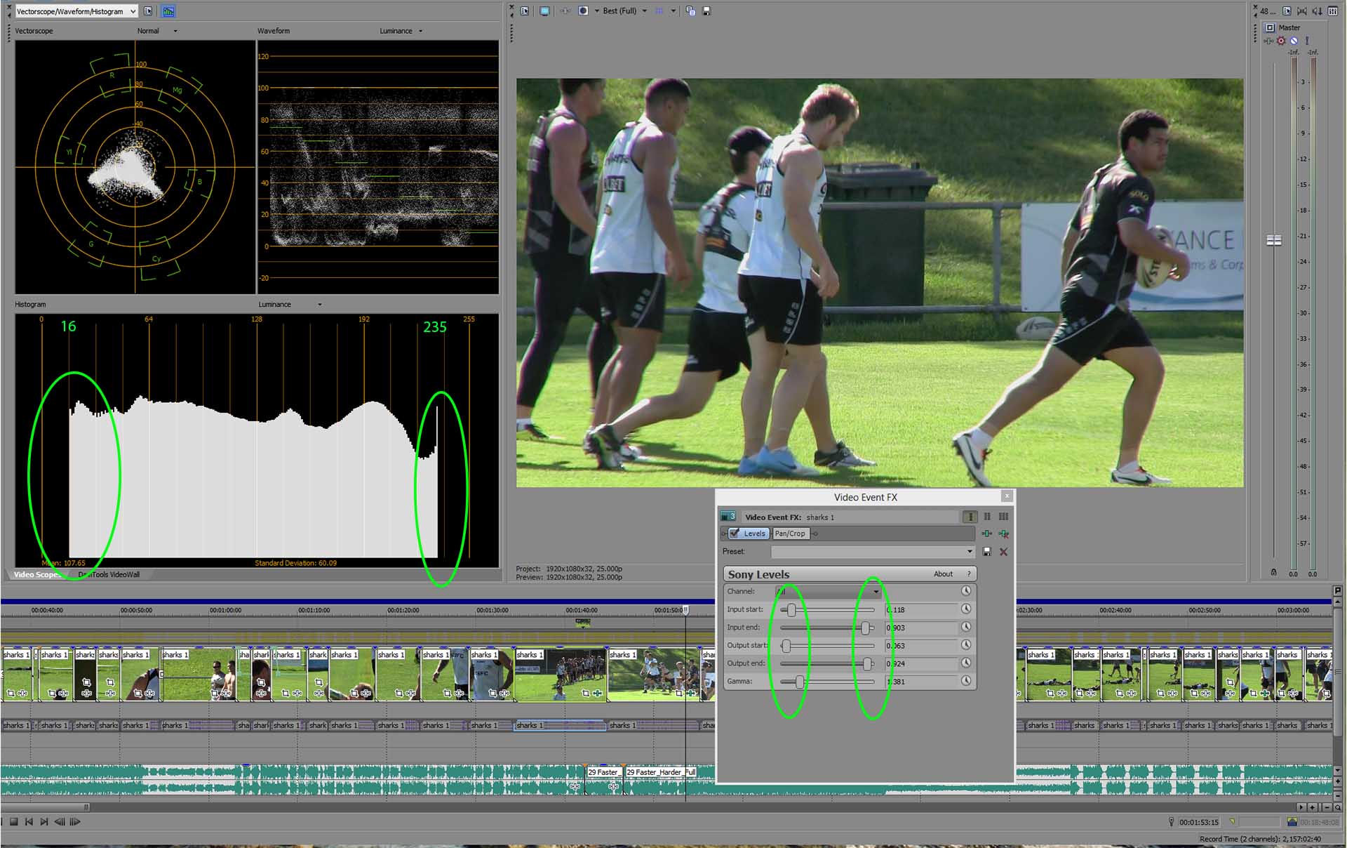

Old March 3rd, 2013, 03:33 AM   #8
Join Date: Oct 2009
Location: Central Coast Australia
Posts: 1,050
Re: Exposure Tweaking - Levels or CC
Hey Chris,
Ill tread lightly here, since I will prob get burned by someone more schooled than myself.
But this works for me.
For DVD anything below 16 on the scopes is black, and anything above 235 is white.
The advantage with using the input sliders is that you can control how much of the greys in your scene become black at 16, and how much the almost whites become white/clipped at 235.
In the grab below, not a great example but its what I have loaded ATM, it was a little overexposed, but with the levels I can put my lows and highs where I want them, and control how much of them roll off to be crushed and clipped on the high end if I choose.
Interestingly, I can brighten the mids and end up with a brighter looking image and still have corrected to the top and bottom end to more acceptable levels on the scopes.
But note it is still within legal levels.
This is really basic, someone more knowledgeable than I needs to go into greater detail for all the variables.

Ok I see where you are going and that makes sense too!! I was only looking at the waveform intead of all the scopes. I can see how you are using the 4 controls to limit to 16 and 235..On mine it was only the bride's dress really that needs a bit of attention. It was in full sun so it really glowed big time!!
The effort to upload screen caps is much appreciated..I'll give that side a whirl on my ceremony footage in the morning
