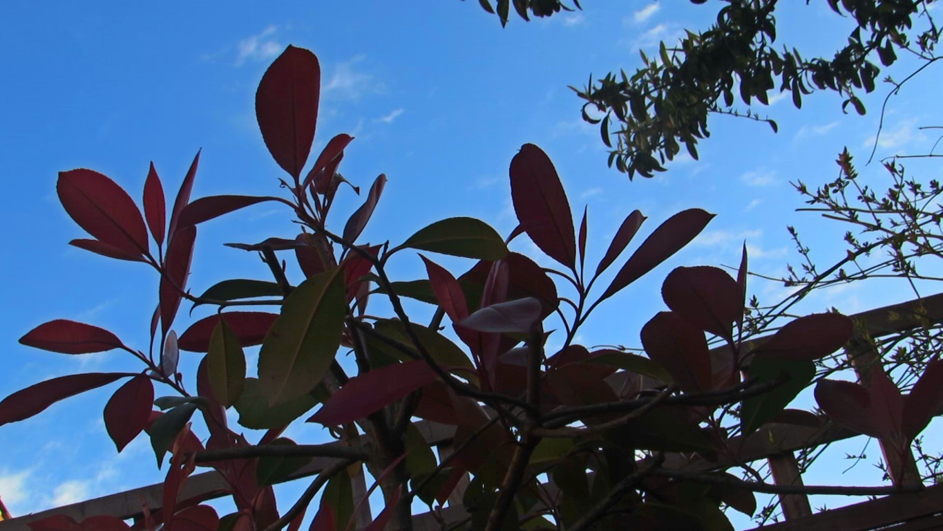

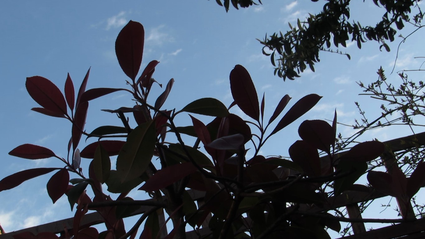

Here's exactly what I like about NBCF. I shot this material yesterday, on purpose to demonstrate to myself just how far I could push CF and improve my knowledge and use of it.
In the Attachments below, the Original is TOP Left. TOP Right is a majorally "popped" Sky, but just look at the way CF has brought out the subtitles of the red in that Red Robin plant. And then the bottom row each of those layers is independently adjusted and adjustable with the Sky now "tamed-down" again. Bottom row RIGHT is potentially my final "take" on it, where I've adjusted "up" the Sky and upped the level of the Midtones to show more of the under-leaf.
The GUI is intuitive and with plenty of fine, incremental adjustments. I have not found the tools, although good for "other" remedial work, in Vegas, to be able to come close or match NewBlue ColorFast.
Cheers
Grazie
