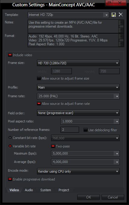

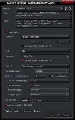

Uhmmm, sorry Renton, but you really dont want to use that for youtube.
one, it uses non square pixels, and two, the compression is very ordinary. File size will be big but quality will be low.

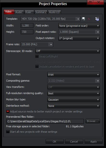

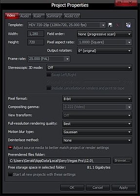

Try these settings, these will work for any widescreen PAL source.
Note the Project settings- Adjust source media checkbox. When ticked this will zoom a little bit on your source media to take up the difference in aspect ratio if there is one.

Try this Renton,
Start a new 1280x720 project,
Now browse in Windows explorer and drag in your Project file (.veg) into your 1280x720 timeline.
Tick the box Adjust media etc in Project settings as noted in my previous post.
Now you are rendering a 720p project to 720p render settings (as in previous post), and you havent had to play with your original project settings.
Too easy :)
