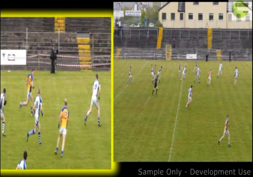

I'll be investing in a new system next month, so while I can put up with a slow render for now, the quality of the finished file itself isn't up to scratch - especially compared with the original footage off the camera.
As for Don's question regarding: Finally what settings did you use to render to MPG? Was it VBR, 2 pass, did you render the audio to AC3?
I don't know, is the straight answer - but what I can tell you is:
When I burned direct to disc using the 'Burn DVD' function, the output format was Mpeg-2 720 x 576, 16x9 PAL.
After the poor quality of that, I tried rendering as Sony .MXF file - as it stated it matched the project settings. I had to stop this half way through tho, as it was going to be too big a file for my hard drive.
I also tried the 'Render As' function in Vegas, using the 'DVD Architect PAL Video Stream' selection. I'm after burning these successfully to DVD last night using 'Wondershare' but the quality is as bad as the previous 'Burn DVD' option from above.
And there was no sound, but from looking around online I was aware there was another job to be done on that - again the footage is most important.
So, bearing in mind the temporary limitations of the hardware I'm using, as well as my amateur credentials, is there anything any of you can advise?
