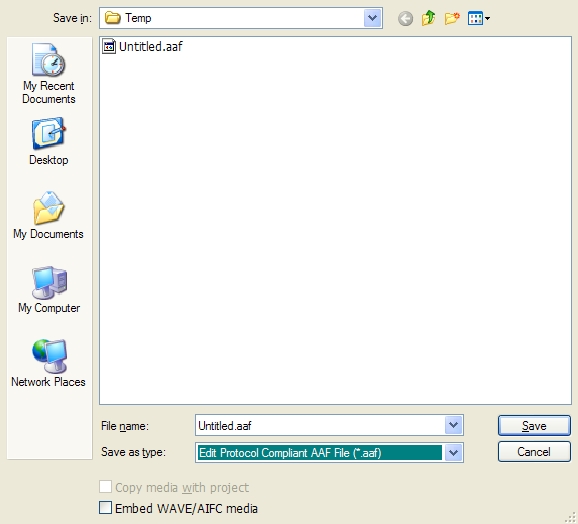

Ian, aaf is a "save as" option, not a render option.
Search the online help menu for "Importing and Exporting AAF Files" as it has a lot of recommendations for doing this. Good luck with the project.
