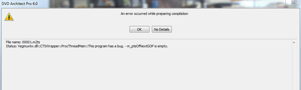

Yes, I did a separate video and audio render. Now there's a new problem.
In DVDA Properties, under Frame Rate, I tried all the different options, because none worked. This is the same error message that DVDA kept spitting out ( see attached).
What can I do?

Norris, I am very sorry, but in years of using DVDA, I have not ever had that message, so I cannot help you!
Hmmm, my first thing would be to move the video files, the whole thing to another drive and try again, making sure DVDA references the new location, not the old. Will this help? Doubt it, but it's the first thing I always try in a weird situation. The message seems to be saying DVDA has a bug, but I don't know! Someone smarter then me should pop in here and help you. Good luck!

You need to render as a Bluray compliant file. This can be found under Sony AVC/MCV in the render as menu. In your case 1920x1080 60i and the data rate can be customized for best quality for your length of program. If its less than about 1 hour 40 then start with the 16M preset and up the data rate. Bluray choices are limited to 60i, 24P and 1280x720P60. So if you shot at 60P then you could do 60i or scale for 720P. I would stay with 60i. If you want to get a 60p AVCHD file then that is possible in Vegas by rendering a Sony AVCHD file and altering the output frame rate to 59.94 ( Double NTSC ).
You could also render as a Bluray MPEG 1920x1080 60i file under the Main Concept setting which will be a lot quicker than AVC render.
