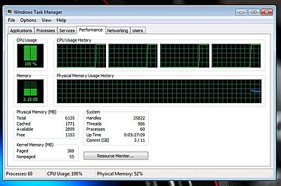

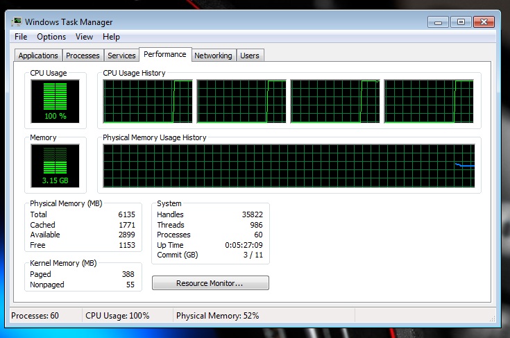

As seen in the attachment, computer becomes completely unusable whilst rendering a 5 minute video. CPU Usage @ 100%. Something must be set wrong somewhere?
