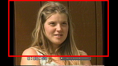

consider a simple crop to remove the timestamp. that is, scale the image so that the timestamp is just outside the visible frame. the red box in the attached image would be what you'd see in the final render. if the timestamp is always in the same spot,it's easiest to do this on in the Track Motion, otherwise you can do it on the Event Pan/Crop for each clip. this only works if the subject is always in the same part (center) of the shot.

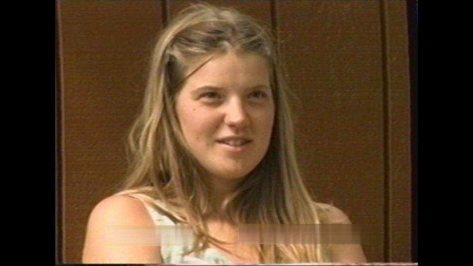

Outside of Vegas, and the Logoaway filter by Krzysztof Wojdon for VirtualDub? I think it is a very good filter.
