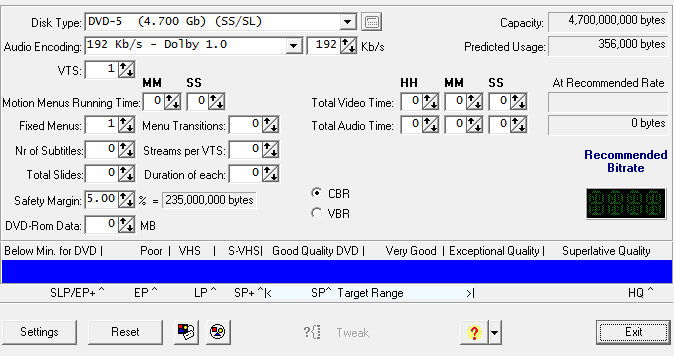

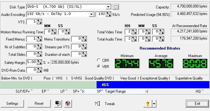

Robert, Don's recommendation is the way I do it if I have multiple files to create for a DVD.
I use the bitrate calculator found at http://www.johncline.com/bitcalc110.zip
It's never let me down and I find it to be a great tool.

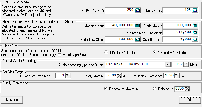

I do make a few changes to it when it first comes up as indicated in the screen shots below.
I change the default safety margin from 1% to 5%.
I click the Settings box and, on the screen that comes up, click 1 kilobit = 1024 bits.
In that same window, I set the Audio encoding type and bitrate option to 192 kB/S as that's the DVDa standard. If you prefer to use a higher value, adjust accordingly.
FYI, I used it set to 2 hours (for your video) and got the following numbers (see screen shot below)

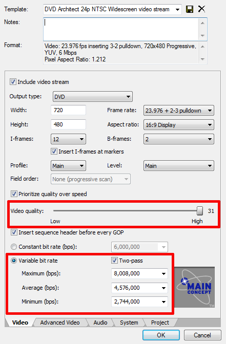

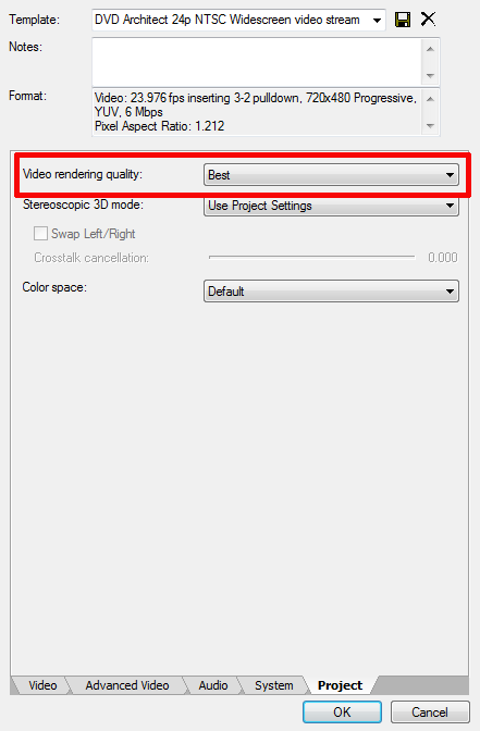

Here are two screen shots from the render settings panel using your two hour timeline for the bitrate I recommended in my earlier post.
Make sure to choose the 2-pass option as this will maximize your final quality. It will take longer but the results will be worth it.
I always set my Video Quality slider to it's highest setting.
On the Project tab (this is in Pro 12), I set the Video rendering Quality option to Best. Once again this will make for a longer render but the final quality, especially still images, will benefit from it.
You can save this as a preset if you know you'll have similar length projects in the future.
