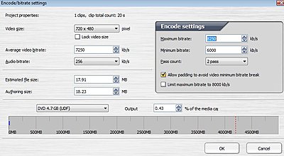

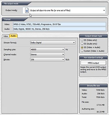

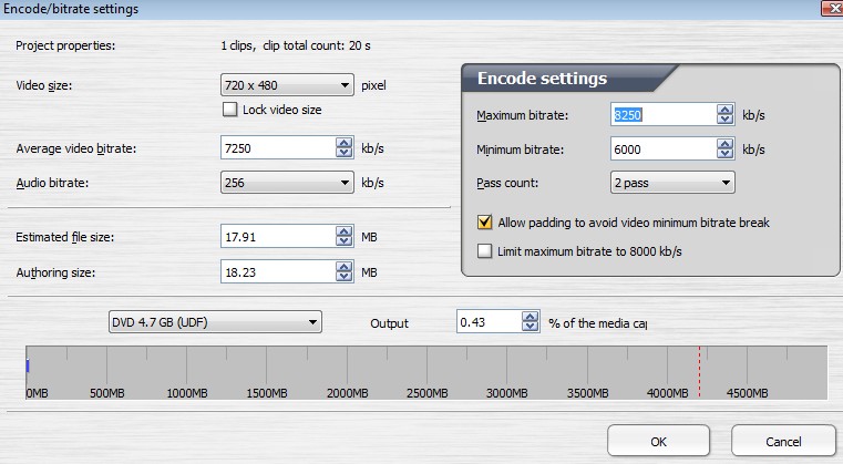

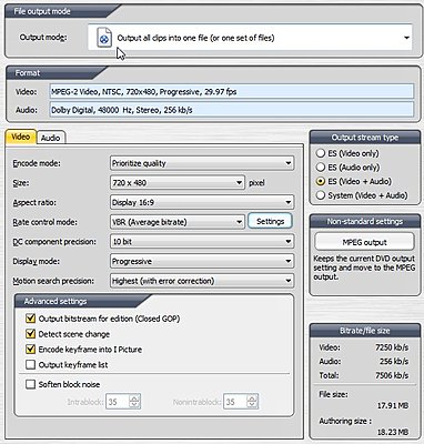

My Tmpgenc DVD settings for low motion scenes. For high motion and short video that will fit on one disk I use constant bitrate at 8250kb/s.
Will TMPGEnc Mastering Works 6 Improve My DVD Quality?-screenhunter_190-oct.-27-11.26.jpg   Will TMPGEnc Mastering Works 6 Improve My DVD Quality?-screenhunter_191-oct.-27-11.26.jpg
Will TMPGEnc Mastering Works 6 Improve My DVD Quality?-screenhunter_192-oct.-27-11.27.jpg
