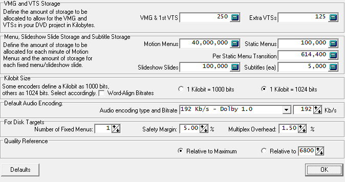

David, if you're referring to Mark's Bitrate Calculator, that's the same one that I use.
The reason for my lower numbers is that I bump my safety margin up to 5% from the default 1% as I like a bit of extra room, just to be on the safe side :-)
The other change I make is to click the 1 Kilobit = 1,000 bits option (found after clicking "Settings".
If anyone wants it, I keep a copy on my Dropbox account at
https://dl.dropboxusercontent.com/u/...bitcalc110.zip
