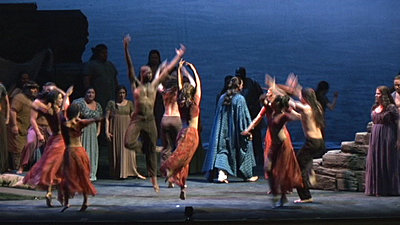

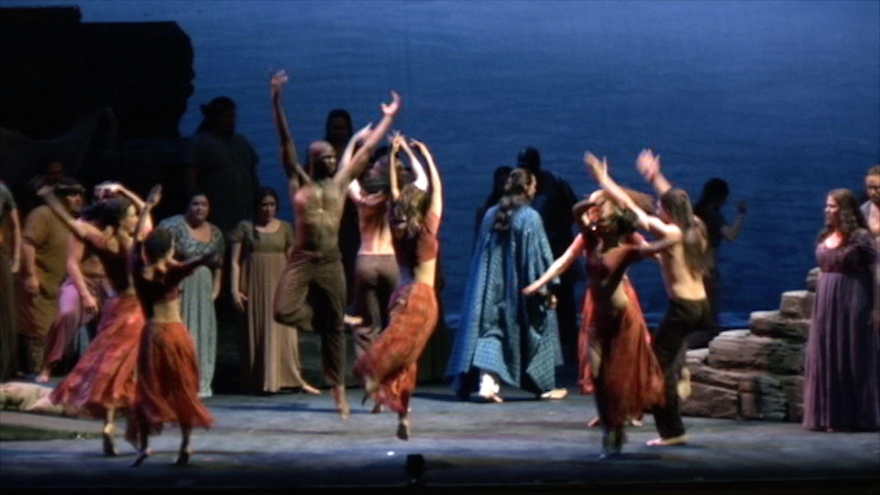

Thought I would follow up on this old thread since the topic is relevant to my current projects. Here's a little two minute montage remembering a special person that passed away a year ago. The original footage was anamorphic 16:9 480i60 DV from my Sony PDX-10 back in 2003 for use in large screen video projections for the Opera Il Trovatore.
PDX-10 footage is a mixed bag. Some of it looks surprisingly good, some of it is horrible. The lighting has a lot to do with it, and the low resolution viewfinder and LCD screen also made it hard to get critical focus. Most of the footage I shot on this particular day turned out pretty well though.
So I used Apple Compressor with highest quality settings to convert the 480i60 to 720p30. The results are kind of soft, but that seems to fit the mood. I did some tests converting 480i60 to 480p30 and didn't like the results as much, I could still see interlace artifacts.
Anyway, here's my little two minute video so you can judge the results of the 480i60 to 720p30 for yourself.

I just realized this thread is in the Vegas forum and I am using Apple Final Cut Pro, sorry for taking things off topic, although I am more interested in the value of converting SD to HD video as opposed to the nuts and bolts of how to do it. So here is another example from footage I shot of the opera "The Pearl Fishers" in 2004 with the same camera. Can't post video due to contractual/union issues, but here is a still 480i60 frame compared to an up-res'ed 720p30 frame.
Getting rid of the interlace is good, but I'm not sure that the results look any better than just letting a TV/monitor automatically scale the video....
