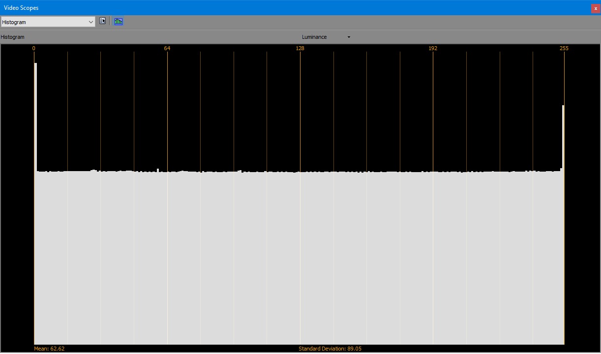

I've been testing levels and colour shifts again on Vegas and to test objectively I have got a JPEG with 256 levels of grey which I drop on the timeline, this has been used for testing various render settings and the correct handling of 0-255 or 16-235 video in my workflow.
In 8 bit video mode, I can preview this image and grey levels are all correct, i.e. I can copy from the preview window and then using a colour picker in an edit package confirm that all the 256 greys are unaltered, i.e there has been no changes or loss of values. A nice flat histogram is attached. I can also render this video and play back and again confirm all greys are spot on by taking a screen grab from my media player on the PC and see there has been no shift in levels or data lost.

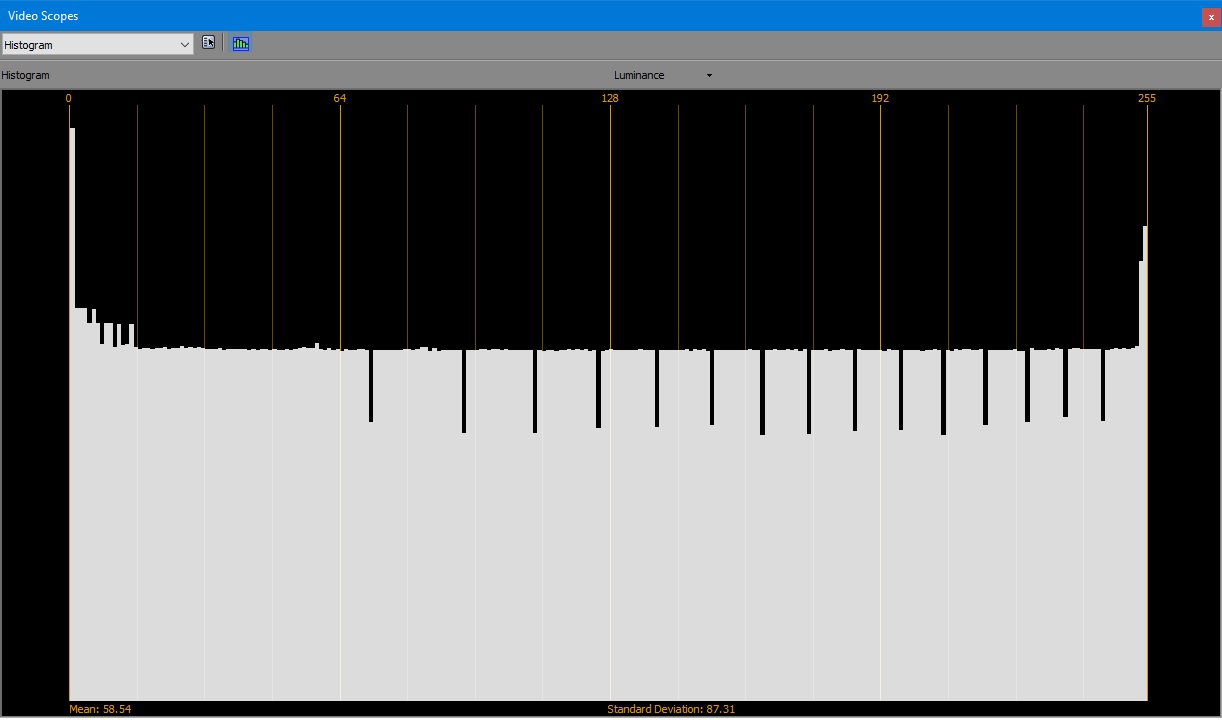

As soon as I switch to 32 bit mode (either full-range or video), I get lost values and shifts in greys and a screen grab and then checking the colour values shows for example that grey with RGB 111,111,111, is now 96,96,96 with all others shifted. All blacks below about RGB 12,12,12 have gone to zero. A histogram shows the changes, see attached.
Surely this is wrong, I shouldn't be losing info just because I've switch to a 32 bit timeline? I should have more values not fewer.

Vegas Levels again - never seems as expected-histogram-8-bit-timeline.jpg   Vegas Levels again - never seems as expected-histogram-32-bit-timeline.jpg

I tried the filter as suggested, it just shifts the comb effect on the histogram so it's still being changed.
