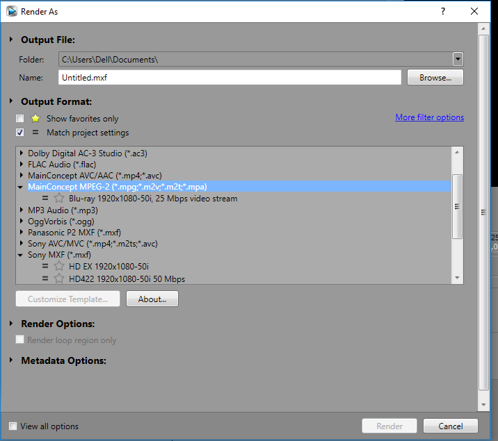

I have been using Vegas Pro 12 for about two years. Today, it has lost all the DVD Architect DVD presets. I have the Main Concept Mpeg-2 heading, but only a Blue Ray 1920x1080-50i, 25Mbps video stream preset.
The DVD Architect DV widescreen preset is not there, so I am unable to render the project as an mpg2 file.
I have uninstalled, and re-installed Vegas, to no avail. The PC is Win 10. Any help much appreciated, many thanks.

The fresh install reset of Vegas is achieved by holding down the CTRL-SHIFT keys while you double click on your Vegas icon to load Vegas. You will then be prompted with a "Do you want to clear the cache" or something to that effect. Answer YES and Vegas will then revert to its original install state.
Hopefully all your DVDA presets should be happy and be back in the family.

Just in case you see something like this, try unchecking.
