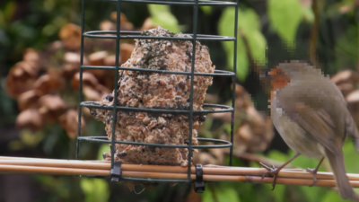

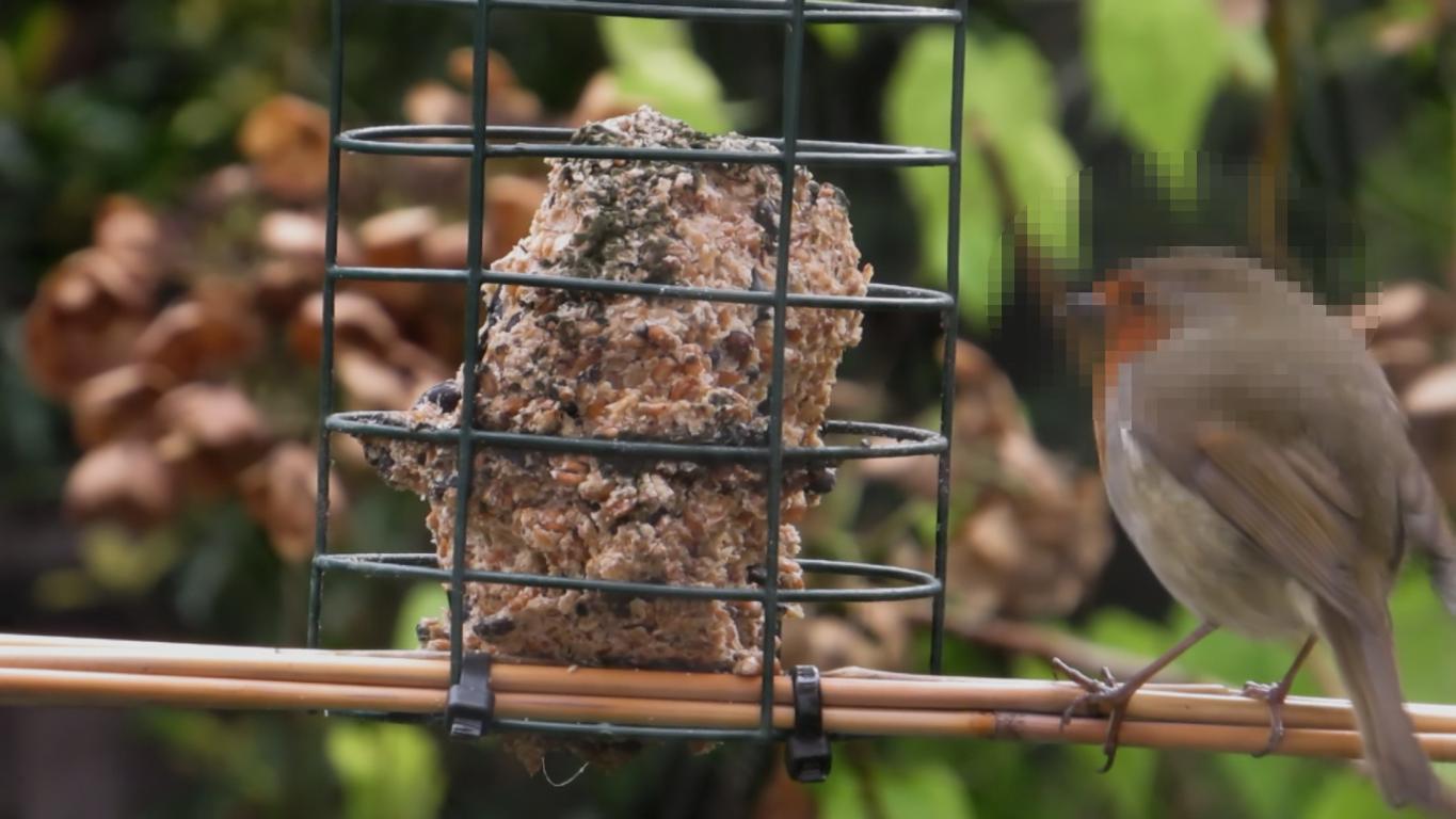

Originally Posted by Gary Bohlk View Post
Is anybody else having pan/crop issues? Trying to pixelate a face and getting all kinds of weird renders. It seems to only do half of an event or doesn't pixelate at all.
Working as expected here. Can't repro your comments.
I'm using VP15 Build 261:
Pixelation Method 1: Successfully used VEGAS Pixelate in Pan/Crop using the Mask and Applied FX control - OK
Pixelation Method 2: Successfully used HitFilm Witness Protection (Pixelate) - OK
Rendered both examples and they are both what I would expect. No issues at all.
What you are seeing could be the result of several things:
1] Setup: I'd need to see your VEG to determine your setup and then need to know what your Project Settings.
2] .NET Framework: I've noticed that VP relies heavily on this Microsoft program to be up to date. I'm up to 4.7.
3] Encode Template: My Encode matches my Project Settings.
Here are the results:
Vegas Pro 15 Update 2 (Build 261) released!-hitfilm-pixelate-medium-.png   Vegas Pro 15 Update 2 (Build 261) released!-vegas-pixelate-medium-.png
Last edited by Graham Bernard; January 12th, 2018 at 03:13 AM. Reason: adding supporting examples

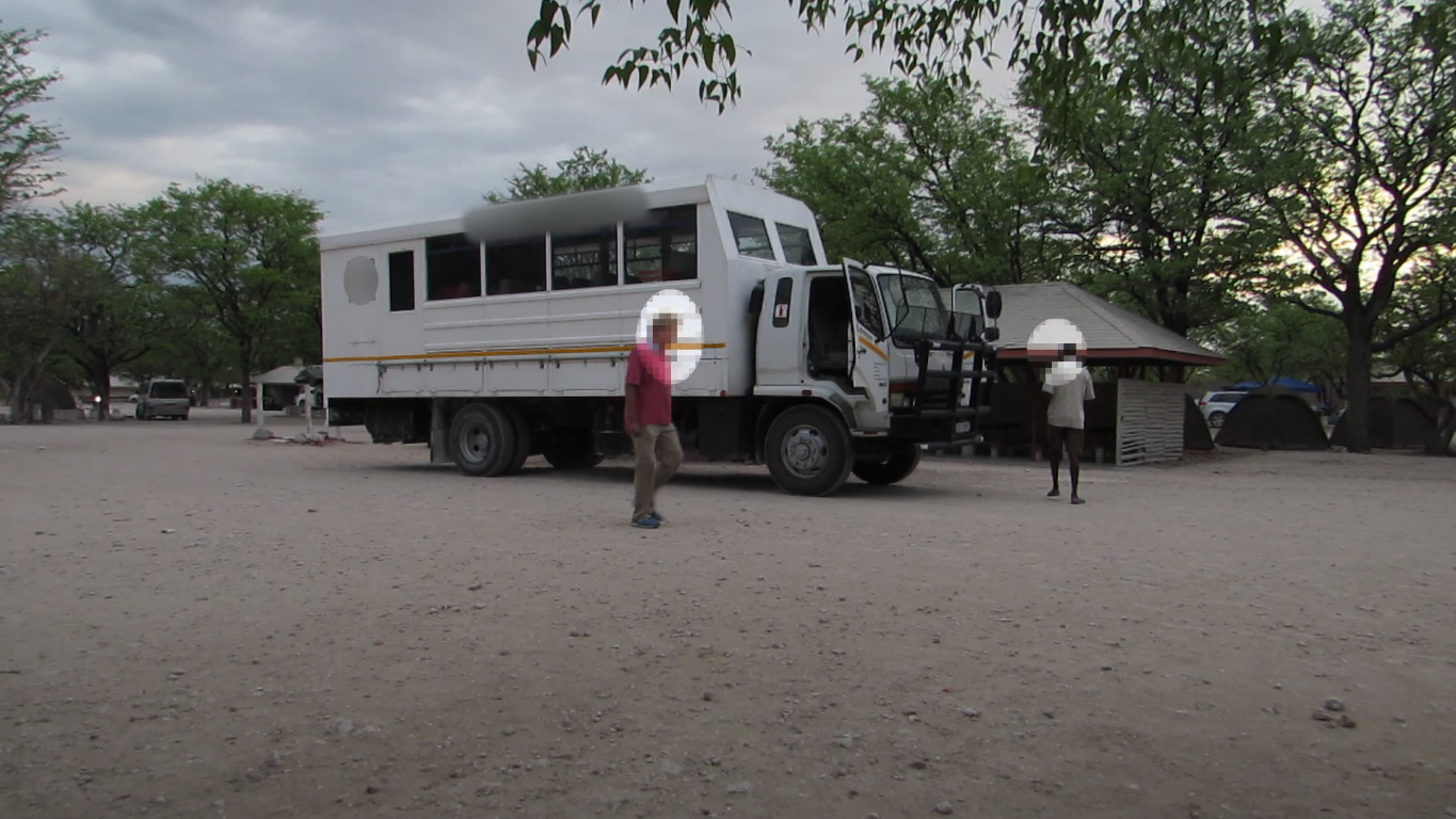

I get the same result you do unless I pan the mask to follow my subject. In your case the bird. I have about 3 seconds where I am trying to pixelate the subjects identity. The pan starts working and then about half way through the 3 seconds it just stops panning and the subject basically walks out of the pixelated mask and is clearly visible.
I've just completed a sample with two people walking, one at speed and one sauntering, and I have BOTH targets pixillated whilst in motion, moving from Left to Right, across the full frame. I rendered to a New Track and the results are perfect. It is working as I would expect. No waste of time here.
Old January 13th, 2018, 01:30 PM   #12
Old Boot
Join Date: Aug 2002
Location: London UK
Posts: 3,633
Re: Vegas Pro 15 Update 2 (Build 261) released!

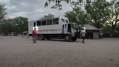

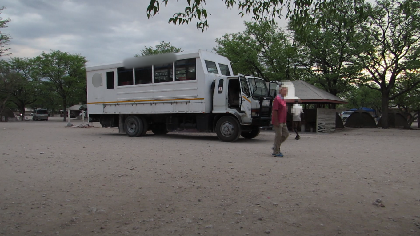

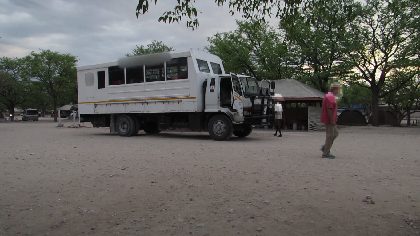

When I preview in the event/pan-crop window the keyframes are there and it follows the subject all the way. When I preview on the timeline...like I said, it stops literally at the half way point. The next time I preview it without mnaking any changes it might pixelate the entire frame but only to the half way point.
Here's a Run through from 2 seconds in to 7 seconds:
http://www.dvinfo.net/forum/attachme...1&d=1515871686
Vegas Pro 15 Update 2 (Build 261) released!-2-seconds-medium-.png   Vegas Pro 15 Update 2 (Build 261) released!-4-seconds-medium-.png
Vegas Pro 15 Update 2 (Build 261) released!-6-seconds-medium-.png   Vegas Pro 15 Update 2 (Build 261) released!-7-seconds-medium-.png
