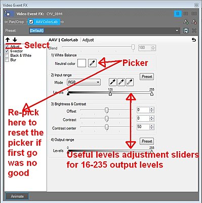

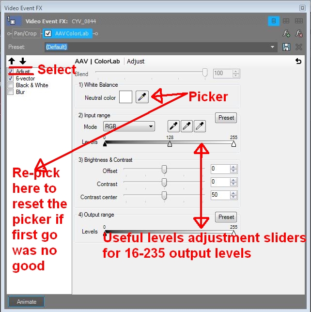

In post #4 I entered the link for the AAV ColorLab plugin. Download the 64 bit one and check it out. In Vegas I don't think you would use any other WB picker once you have used it. If you have made a bad pick to reset the picker just click on a white are of the plugin interface then re-select the picker and again choose in your picture what you want to be white.

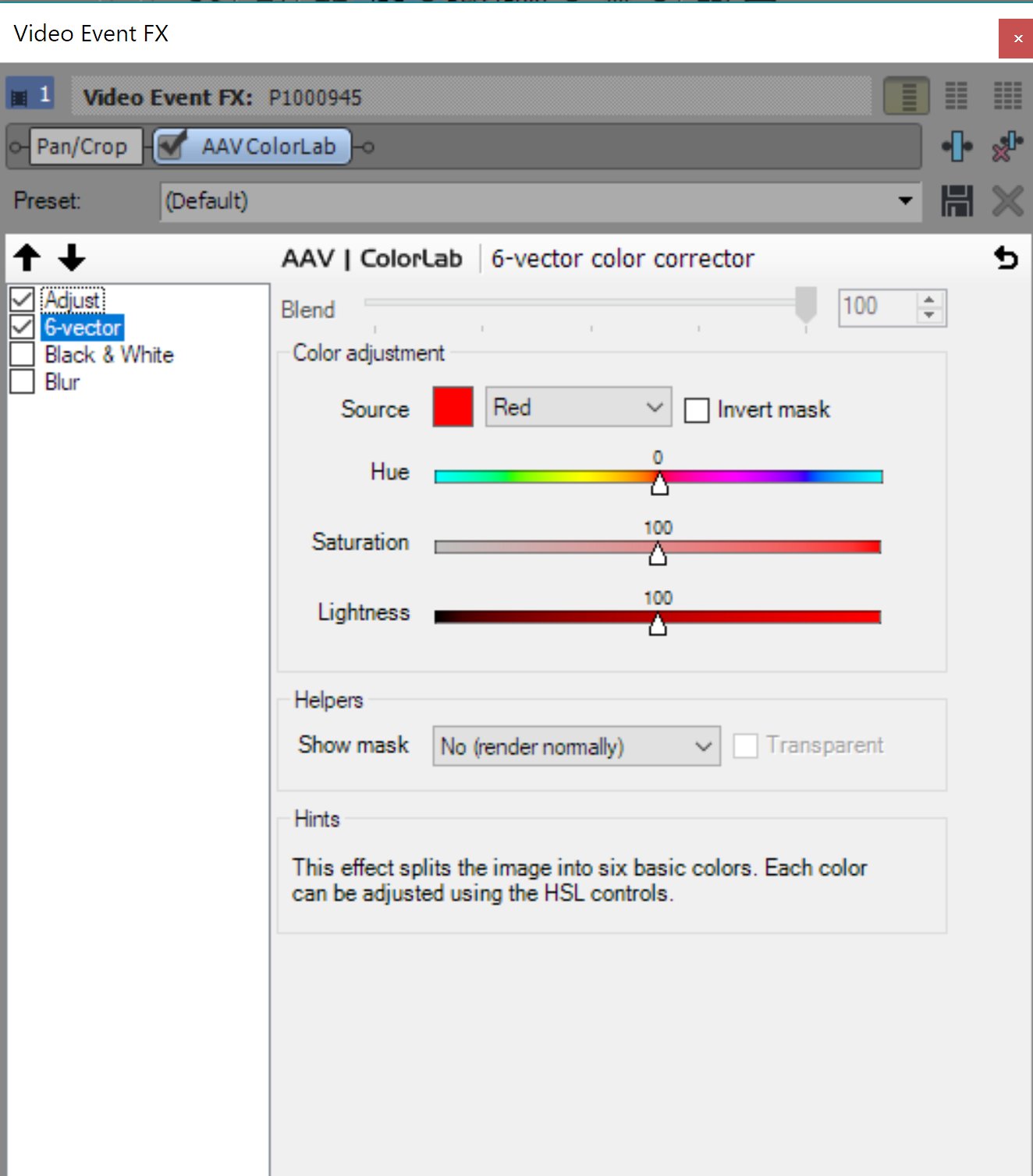

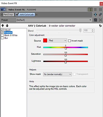

Thankyou Christopher, and I did download the 64 bit plugin and was somewhat puzzled by that which appeared when I selected it in Vegas Pro 14 and Vegas Pro 13. Here is what I see.

You need to select the top left checkbox if and then click on "adjust" to access the WBal panel. Then follow the info in the screen grab. Easy when you get the gist of it :))
Chris Young

Ah, why didn't I think of that!
First the good news; it works in Vegas Pro 13 just like the built in WB adjuster. The not so good news (though I'm hardly surprised) is that it does not work in Vegas Pro 14, just like the built in WB adjuster.
