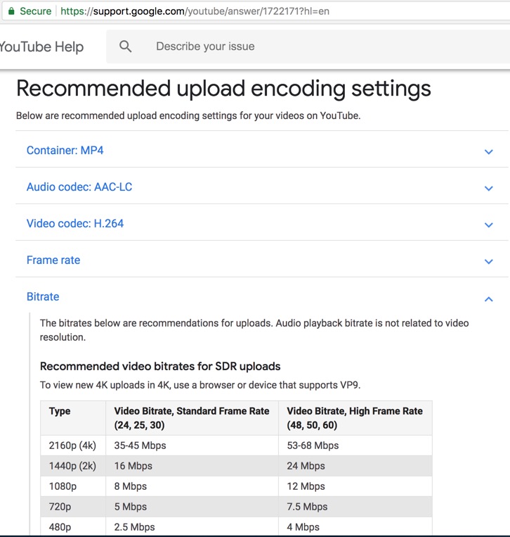

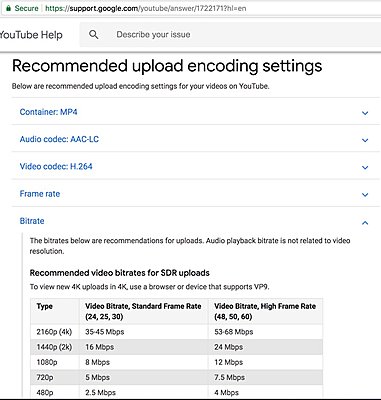

Mainconcept AVC/AAC is a high-quality encoder, if you give it enough bitrate. Given that you're shooting moving water, which is about as bitrate-hungry content as you can get, you'll want a fairly high setting of perhaps 12Mbps for 1080p material. Are you currently editing at 1080?
When you upload 4k you need more bitrate!
Here is Youtube's support on bitrate. For moving water, go to the high end of the settings!
Those are some of the sweetest most tubular tubes I've seen in a while! Be sure to post back when you have a new version up!
Help me with rendering settings for higher quality YouTube-yt-encoding-recc.jpg

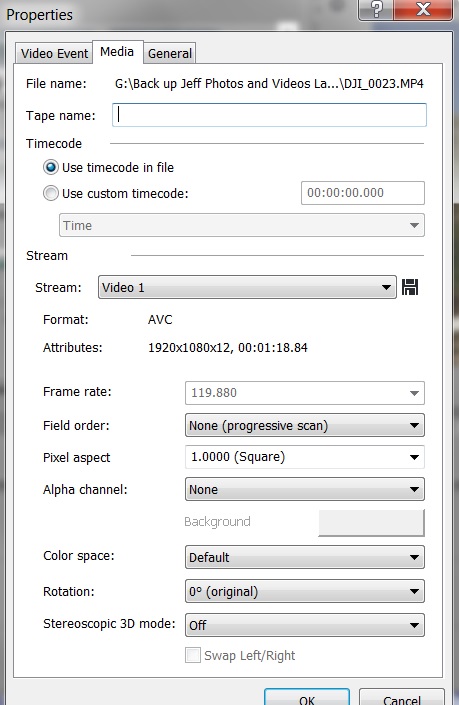

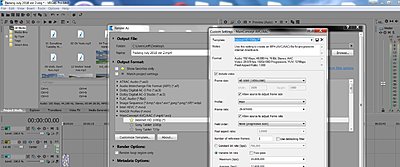

OK, I did another rendering following some suggestions you guys offered. I also screen shot what settings I used. Please give feedback and suggestions.....and THANK YOU!
Help me with rendering settings for higher quality YouTube-aaa-rendering-vegas-youtube.jpg

Old August 7th, 2018, 02:10 PM   #9
Join Date: Oct 2015
Location: Navajo County, Arizona
Posts: 109
Re: Help me with rendering settings for higher quality YouTube
Hi Jeff,
This second sample I'm sure you agree looks much better than your first. The drone footage looks the best. I wonder about the footage you took from what ever camera you are using at sea level from a housing. It just doen't snap, looks rather low quality.
For your render settings I would uncheck both 'Allow source to adjust frame size' and 'Allow source to adjust frame rate'. Make sure in the 'Project' tab of your render template you have selected 'Best' in 'Video rendering quality:'
You may also want to try upping the 'Maximum' and 'Average' bps from 24,000,000/12,000,000 to 50,000,000/25,000,000. Youtube processes all videos uploaded and almost always there will be to some degree a loss of quality. Some say start with a higher bite rate, so when Youtube downgrade processes it the video will be left with more bit rate, than if you started at a normal bit rate. Others, say increasing the bit rate will not do any good and is just a waste of bandwidth. I've never spent anytime to determine who is correct in this debate.
Can you post a screenshot of your 'Project' settings. Also, a screenshot of your source media specs within this last project. The most informative with be from 'Mediainfo' in 'Text' mode.
Your action videos are going to look a bit better if you publish in 60p rather than 30p. If I were doing this project I would eliminate any footage shot in 30p, and only use 1080-60p for the normal speed scenes and 1080-120/240p for slow motion scenes. You could also use ProDAD ReSpeedr of Twixter for the slow motion scenes.
Another consideration if you are going to stay with version 14 and want to keep upload files a reasonable size is to frame-serve out of Vegas to Handbrake which will provide a better quality render than MainConcept and a smaller file size. If you are interested in frame-serving I can provide a link to a good 'How-To' tutorial.
Best Regards.....George
George Dean is offline   Reply With Quote

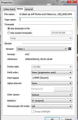

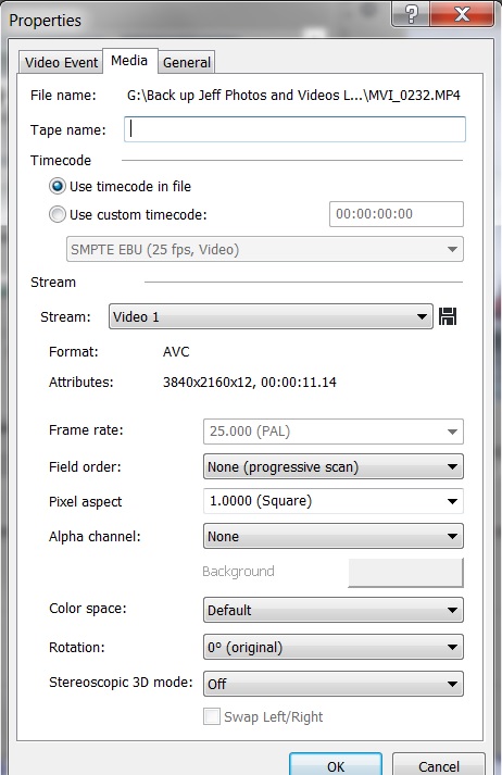

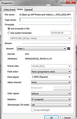

George, Seth, and Chris:
See attached video specs in photos.
I shot the phantom 4 pro drone shots that came out better in the video at 1920x1080x199.88fps.
I shot all beach shots with my Canon M50 and Canon 70-200mm lens using 4K at 25fps.
Obviously the drone shots look better, especially in slow motion. I haven't shot this option yet but should; the M50 has 1920x1080 x 50fps capability.
I plan to get a Sony A6300 for water housing video shots. It has 1920x1080 x 120 fps. It sounds like I should get a lens adapter and use it as well for shooting on the beach with my 70-200mm canon lens. I could shoot it with the Sony 55-210mm lens but my bet I'd it isn't as sharp a lens.
I will try upping the bps from 12 to higher as Seth suggested on this edit and render again. I got to read up on things like handbrake, know nothing about it.
I think the lesson learn is don't shoot at 25fps for surfing. I consider this video I shot as a learning tool anyways. Also keep in mind though on second YouTube I posted that clip the 1 minute mark end the clip at the 1:50 minute mark are both shot with the M50 4k at 25fps. The point I am making is the clips like the one at the 1:50 minute mark were shot late in the afternoon, backlite vs the one at the 1 minute mark was morning sun with light hitting the surfer so time of day also affected video quality.
Ok, any feedback on the M50 I shot at 25 fps vs its ability to shoot at 50 fps and the option of shooting with a Sony A6300 at 1080 at 120 fps would be appreciated.
A side note is the reason for picking the Sony A6300 is the housing company here in Bali (Liquid Eye) builds them for the A6300 plus the camera, housing are cheap, and the size is small. Lastly, prefer not to spend more money on a camera going in the water considering possibility of water damage. If you really think there is a better, small and affordable camera for water photography I would love to hear about it. I just got to make sure that camera is affordable and I can get a good water housing for it.
Thanks for holding my hand through my learning process.
Help me with rendering settings for higher quality YouTube-drone-1080p-120-fps-padang-settings.jpg   Help me with rendering settings for higher quality YouTube-m50-padang-1080p-25-fps-specs.jpg

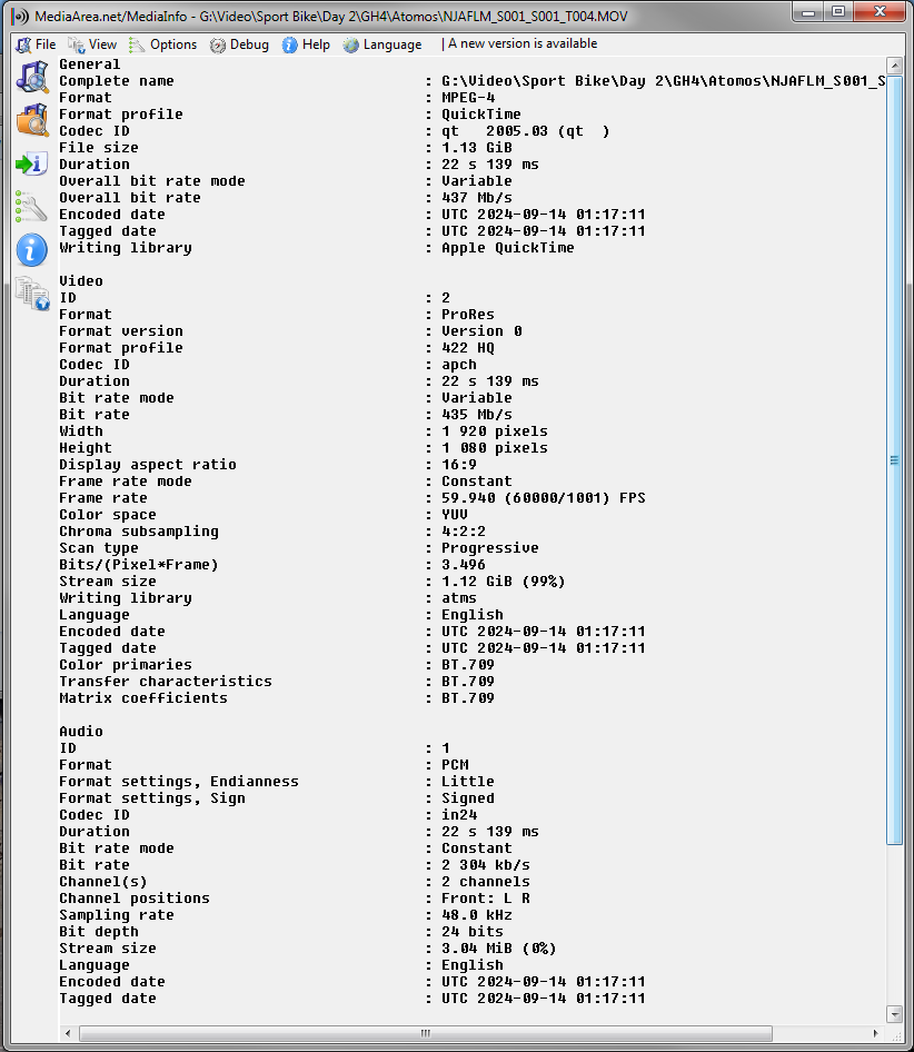

1st, when posting screenshots of your source media specs, it is preferred that you use the free application 'Mediainfo' (download from here: https://mediaarea.net/en/MediaInfo ). Start the program, click on the 'View' tab, then select 'Text' mode. Click on the 'File' tab to load your source media file. The screenshot should look something like this (see below):
When and if you want to setup and use frame-serving and Handbrake, here is an excellent tutorial. Takes a bit to get setup, but well worth the effort and once setup, it is a snap to use: https://www.moviestudiozen.com/free-...o-to-handbrake
If you like that setup, then I would suggest you look at this tutorial on basic Handbrake setup, as well as, hundreds of others on the web how to get the most out of Handbrake: https://www.moviestudiozen.com/free-...xport-settings
If your final delivery is going to be Youtube, I would record in 1080-60p on the M50, then you will have 60p for your base fps, and use the 120p from your DJI and A6300 for slow motion. Those frame rates match evenly so it will provide smoother motion over all. Any 120 fps footage you get that you want to speed up to standard motion, Vegas will handle very well. ProDAD ReSpeedr application is relatively inexpensive and you may want to download their trial version to test and see how well it will provide slower motion from you 120p footage for super-slow motion.
Also, Magix has a deal now, buy Vegas Pro 15 and get Vegas Pro 16 free at the end of this month when it is released and I think they are including ProDad ReSpeedr free.
I think id you film at minimum 60p (50p) and up the bite rate on rendering, and use Handbrake for the rendering (see note 1 and 2) you should be getting better quality.
Note 1 - If you do purchase Vegas Pro 15/16 you will get included in that Magix AVC render format, which is better quality than MainConcept, and may also support your GPU which means your renders will be faster. Again, they have a trial version available if you haven't already tried it.
Note 2 - There may be some setting in your M50 that will improve the quality of the footage you shoot from the beach (although after you get the A6300 and housing you may not shoot from the beech after that). Shutter speed, ISO, etc. If you haven't explored the options, there may be something in your camera that will improve the quality of the source media from that camera. Just a thought.
Hope some of this helps.....
