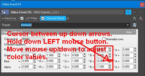

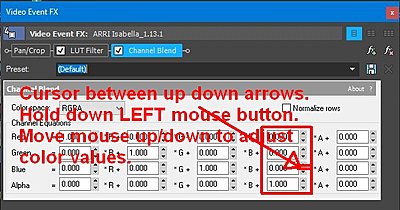

If you want very powerful white balance correction but with fine subtle adjustment use the "Channel Blend" plugin.
Select and add this from your Video Event FX. Once this is applied to a clip hover your cursor between the up down arrows on the FOURTH row of boxes on the color you want to add or subtract. If your image is too blue then this would be the blue adjustment box, third row down, and then adjust blue to the minus value. How you do it is to hover your mouse between the little up/down arrows on your selected color. Doing that you will see two horizontal lines appear. Now hold down the CTRL button and the the LEFT mouse button. While holding down the CTRL and LEFT mouse button push your mouse up and down to increase or decrease the color value of your chosen color. By adding and subtracting values carefully in the RGB boxes, the top three boxes in the fourth row, you can dial in a near perfect white balance.
You can of course apply the Channel Blend in your Project Media pool by right clicking on a clip and selecting "Media FX" and apply your color correction there. Doing it this way any clip selected from that particular media will have that correction already applied to the clip when it is added to the timeline. Copy Paste Attributes is then not required.
