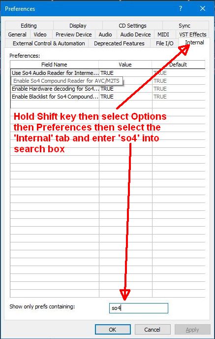

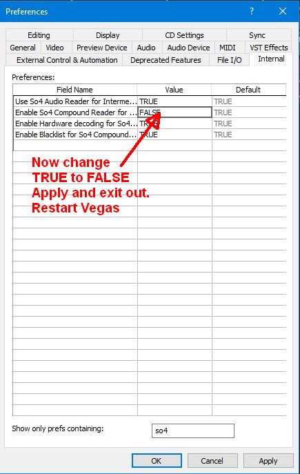

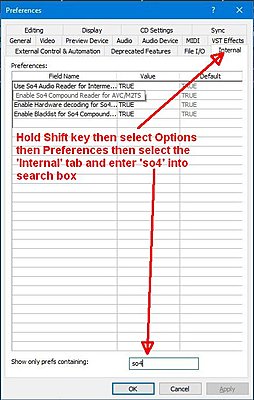

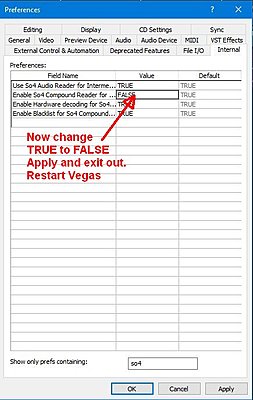

Haven't tried it with HEVC Robert but the following steps work with a few cameras and only the first audio tracks come in. Select Options then Preferences while holding down the Shift key. Make sure you are holding down the Shift key when you select Preferences. A new tab called "Internal" will appear. Select that tab then search for "so4" and change the illustrated entry from TRUE to FALSE and see if this sorts the problem.
If it works with the new Panasonic let us know.

Hi Chris,
Thanks for the information.
I did try the above but it did not disable the 4 track import.
I did get in-touch with Panasonic and suggested an 'option' for 2 or 4 track in next firmware update. They did link me to previous firmware, so I may just roll back to that (supported 2 track only).
Thanks for the help.
