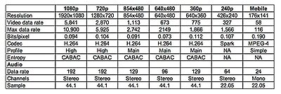

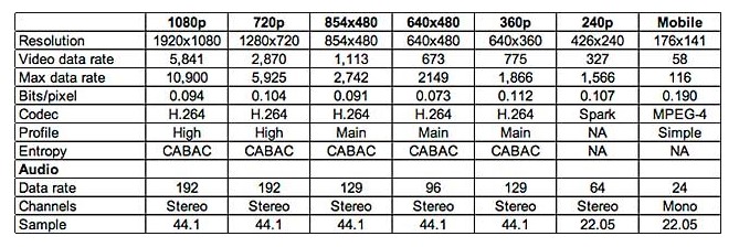

I find trying to define what's best in settings is not a one size fits all. The end quality of your upload video is greatly affected by just how good your original footage quality was with regards to bit depth, bit rate, and noise levels. Finally, the end result of your Youtube upload is dependant on just how good your master file is. The higher the bit-rate and quality of the master is the better your end delivery quality will be generally speaking. The higher these are the lower the bit-rate you can use on your Youtube uploads. Take for example the high-quality footage that was used in Davinci's latest v17 intro. This HD clip as it sits on Youtube is delivered with an overall bit-rate of 939 kb/s using x264 and plays out at 24 fps. Similar results can be obtained from Youtube uploads starting from as low as 8Mbps if the upload quality is of a high order. The whole 1 hour 39 minutes of it looks good as all of its content was top quality footage to start with.
I had to do a whole series of medical videos of around 60 to 90 minutes long for medical training seminars. The brief was it must play well even on a student's low-end 500MHz laptop for example. Also to try to keep the lessons to no more than 750MB in size for their online teaching portal storage. Quite a tough ask that meant we had to look at low bit-rate encoding for delivery.
For the original camera footage, we shot on an FS7s using 422 50p. The edit stayed in XAVC-I at 422 50p which is a 500Mbps codec. The end encoding at low bit-rates stands up well. We used 768kb/s which is 6.14 Megabit per second encoded to x264 for the deliverables. Where we did encounter problems was when we had to include existing file footage in the lessons. Footage that incorporated various codecs and bit-rates. Some of these segments were definitely down considerably in quality after encoding compared to camera original footage. To help resolve that problem I re-processed all the archival footage through Neat Video and rendered it out using Cineform wavelet at its "High" setting. This helped the archival footage no end. Why Cineform? It tends not to induce blockiness as much as similar spec DCT masters on low bit rates H.264 and x264 exports. The exports may get a bit softer to watch on high-motion material but that is IMHO preferable to encoding blockiness in your exports. I've found generally rendering H.264 or preferably x264 from Cineform delivers the best overall results. Without question on lower bit-rates encodes Cineform wins for me. Once you get over about 8Mbps the differences between H.264 and x264 become far less discernable.
Video compression is a garbage in/garbage out medium, and more is always better when it comes to data rate. However, if upload time is a concern, as it is with me, I wouldn't go much higher than 8Mbps unless the footage was extremely difficult to encode or of pretty average quality.

Prime quality upfront is the answer to most encoding quality issues. Garbage in garbage out.
Chris Young
This Resolve intro is an HD clip at an overall playback bit-rate of 939kb/s which is 7.46 Megabit per second using x264 and playing back at 24 fps. Hard to argue with the end result for a low bit-rate Youtube encode and playback.
Youtube will encode six streams not counting mobile for video playback from an HD upload.
Best settings to render to you tube and FB. Mistakes?-youtube-encoded-deliverables.jpg
