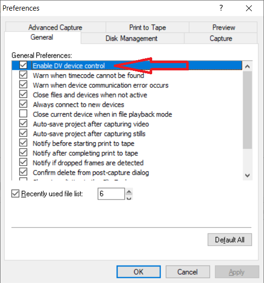

When device control is turned on, the capture program will try to tell you camera to "play" to start the capture. With device control turned off, it will just capture whatever is passed through. If yours is working correctly, it sounds like it may be turned off. I know the option is in the DV capture option but it may not be in the HDV option. You just don't want the capture program to control the camera. You only want it to capture what is coming in.

It would be in the preferences. If everything is working correctly for you, I wouldn't worry about it. I don't have a firewire card in this laptop so I can't get to the correct place to check for HDV. For DV, it's in this attached image.
Recording a sport event with Vegas 16 and an old Sony FX1-dvdevicecontrol.png
