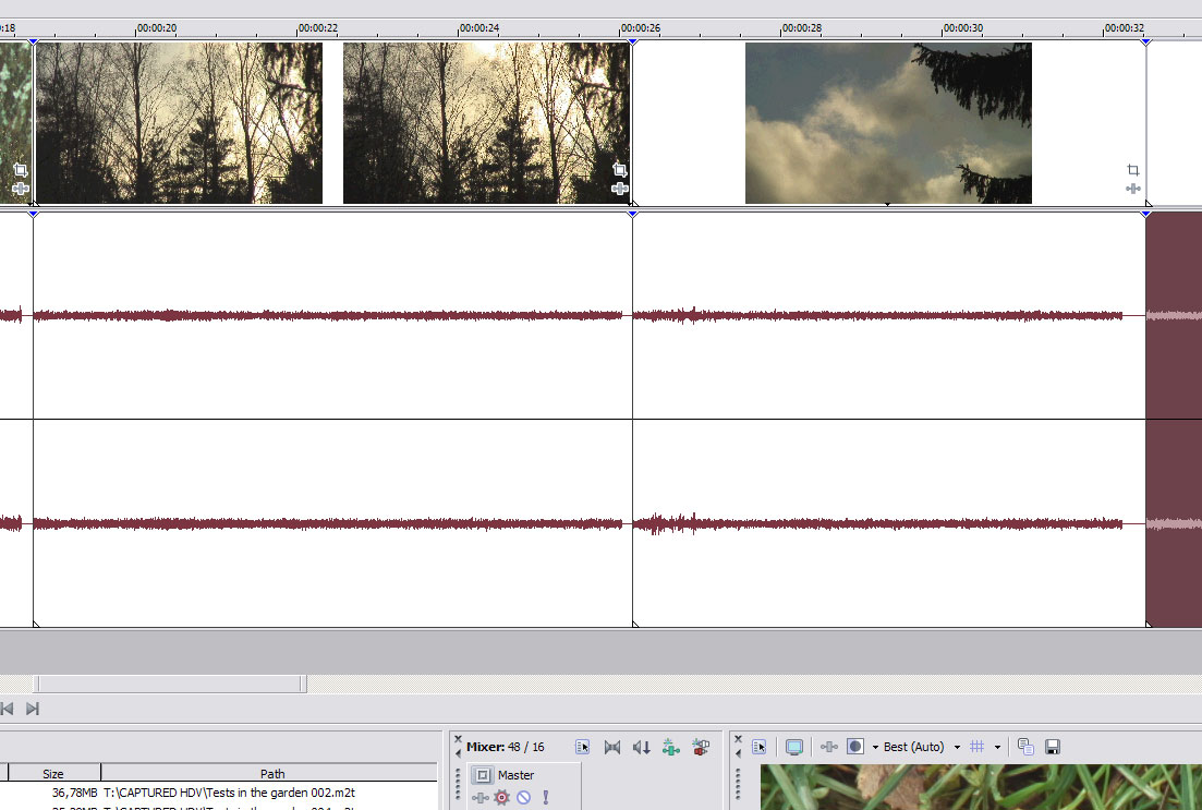

Anyone else that has problems with the following?
I am capturing HDV in Vegas 7.0c from a HDR-HC1E (PAL) using FireWire. The audio is missing for a couple of frames at the end of every scene-detected clip. There are no dropped frames no whatsoever, and the video capture is perfect. This is very annoying and renders the clips unusable, unless you manually crop each of them at the very end.
I had big hopes that Sony would have fixed this in 7.0c - but no!!! I reported this problem at the very first day i got the first 7.0 loaded and tested the HDV scene detect feature. No comments from them since. Every 7.0 x version suffers from this problem, even the just recently released C-bugfix.
Everything else works fine, DV-import is no problem and works great.
Please anyone with this combination of equipent & sw, can you confirm this malfunction.
I think that Sony has not yet to release a fix for the HDV scene detection to work properly... Would like to get this confirmed.
Please see the attached screendump where the missing audio can clearly be seen in the expanded audio track...

I do see the next frame at the end in preview, I suspect this may be part of Vegas cutting on the I frame.

OK, I have now made some thorough(?) investigation of the matter. I've tested following apps and file formats:
HDVSplit -> m2t
Vegas VidCap -> m2t
Cineform HDLink -> m2t
Cineform HDLink -> AVI (CFHD)
Material is PAL 25 fps.
I captured the same tape with the same equipment (HVR-M15E) except with HDVSplit where HVR-A1E was used.
It really is that the capture app is affecting to how the sound is managed. I do have screenshots to prove this but for some reason I cannot find a button to upload any material here.
Cineform HDLink capture to m2t did not split scenes so I got uniterrupted reference material of the sound on tape. Both Sony and HDVSplit will mute the sound before video ends. Sony being worse on this. Cineform CFHD-material did not have any mute on sound but the scene detection (or decoding algorithm) cuts the file well before any muting happens in Sony or HDVSplit. So with Cineform you actually lose material.
HDVSplit scene detection let material to "bleed" over the scene change at least in one place.
And one notable thing also: Cineform CFHD -material has the audio lagging approx two frames compared to m2t material.
So Christian, you were right from the beginning.
