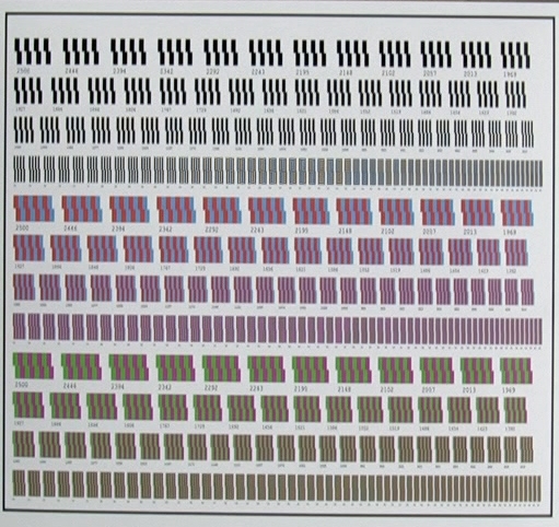

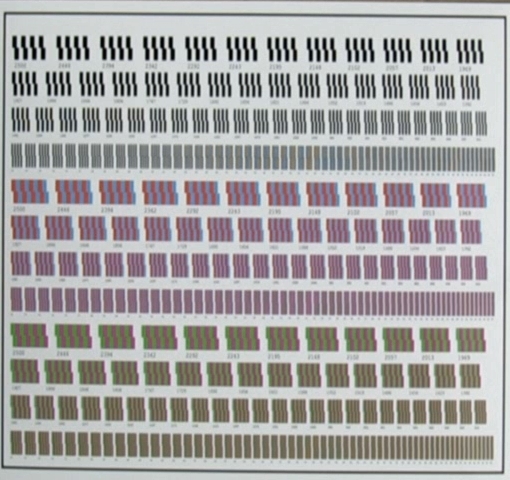

I’m still looking for a method to compress my HDV movies to such an extent to be able to fit approximately an hour of footage on a double-layer DVD, in order to distribute to people who don’t own a Blu-Ray or HD-DVD player. The original format is 1080i and I would like to maintain quality as high as possible.
The solution seems to be a WM9 format, but I found the following problems:
- If I use Vegas 7 (with the color corrector), and compress to Windows Media format, I get a huge loss of sharpness: it’s not a compression artifact, it looks more like a “blur” filtering (the attached example shows a detail of a frame in a static scene)
- Alternatively, I downloaded and installed Windows Media Encoder, but if I try to convert a .m2t file, the PC “thinks” for a while, then states that an error occurred reading the file. The same happens if I convert first the file to an MPEG-2 Program Stream (.mpg).
I would like to ask if anyone succeeded in getting HD WMV files without loss of resolution.
Marco
Rendering problem: wrong brightness/contradt/levels to wm9 or Divx etx-original-hdv.jpg   Rendering problem: wrong brightness/contradt/levels to wm9 or Divx etx-compressedwm9.jpg
Marco Durando is offline   Reply With Quote

Solution found !
I’m writing to share my latest experience about the solution I’ve just found about the problem described in my previous post. Maybe most of you already knows, but I hope it can be useful to anybody.
I was trying to compress my PAL interlaced 25 fps movies into Windows Media 9 using Vegas 7, but the result was poor in sharpness. I realized that the problem was due to deinterlacing that occurs when compressing: then I tried to set the output velocity to 50 fps and, believe it or not, the result became incredibly sharp !
Moreover, the movements are much smoother and moving objects look even sharper than in the original .m2t file.
I suppose that with this setting Vegas interpolates odd and even lines in a better way to get the final 50p movie; surprisingly, the bitrate doesn’t increase a lot with respect to 25p setting, although there are twice as many frames, maybe because the differences between two adjacent frames are reduced.
The only drawback is that the rendering time is doubled, but I can live with it.
Using “Quality VBR” and Quality 79%, I get approximately 115 MByte per minute, thus a Double Layer DVD should hold more than 70 minutes of wonderful 1080p footage (playable on a PC) !
