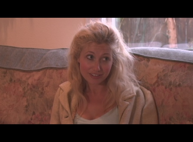

Well, for some reason, now I can send attachments, so here they are.
Ruben

That looks like a pretty typical conversion, Reuben.
David Jimerson is offline   Reply With Quote

Unfortunately, then I can't use the conversion if I'm going to lose that much resolution (it's very noticeable if one clicks on those icons and sees it blown up...and especially noticeable when I render the whole project together and view it on a DVD.)

To be honest, I really don't see that much of a difference. Where are you seeing the really objectionable areas?
It's a tiny bit less sharp, but you might be able just to put a little bit of a sharpening mask on it.
Old January 15th, 2007, 11:35 AM   #15
Location: Stockton, UT
Posts: 5,648
Ruben, it's SD, it's not going to stand being blown up very well anyway.
As David mentioned, it looks perfectly normal to me.
You might try unsharp masking, and denoising...
