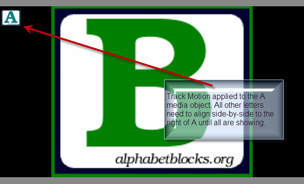

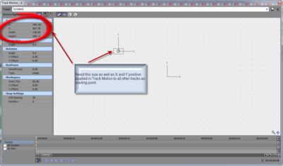

I'm posting my question to this old thread because the topic is the best fit, although the original posters actual requirement was a little different.
I have 26 tracks, one for each letter in alphabet. I want each letter to appear side-by-side at the top of the screen. I'm using Track Motion because I need to position some of the letters outside their object space.
I applied Track Motion to the first in order to size and position the first letter A. Now I'd like to copy that track motion to all other tracks as a starting point for size as well as X and Y positions. All I'll have left to do then is simply change the X coordinate for each of the other tracks.
Thank you.

Re: How to copy track motion keyframes
After setting up the first track, right-click a blank area of the track and choose "Duplicate Track"
Hey, Ed thanks for responding. I had tried that, before posting, but it didn't work correctly.
I didn't notice that when I delete the media that came across with the copy of the track, I lost the keyframe. I just realized that I had "Lock Envelopes To Events" on. So I turned it off before creating the copy and now it's all good!
Thank you!!
