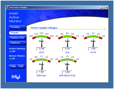

Jeff, you don't want to blow-off motherboard monitoring. It's a small app and is extremely useful. Video editing and other surprising uses (e.g. printing with some inkjet printers) will tax your computer to its limit.
You really need to know that the voltages and TEMPERATURES are in zone. It's doubtful that you'll have voltage problems, but temp ones are pretty common. And w/o monitoring, you won't know there is an issue until it's too late.
I'd bet my last dime on your computer having this monitoring ability. Ask Dell, post on their forums, seach the net, but seriously, you need to know that everything is a-okay when putting a heavy workload on your computer.
BTW, here attached are two screen prints from my mobo's monitoring prog. This info let me know that my system was running way too hot when color printing. It would have fried long ago if I didn't get a cpu cooler.
