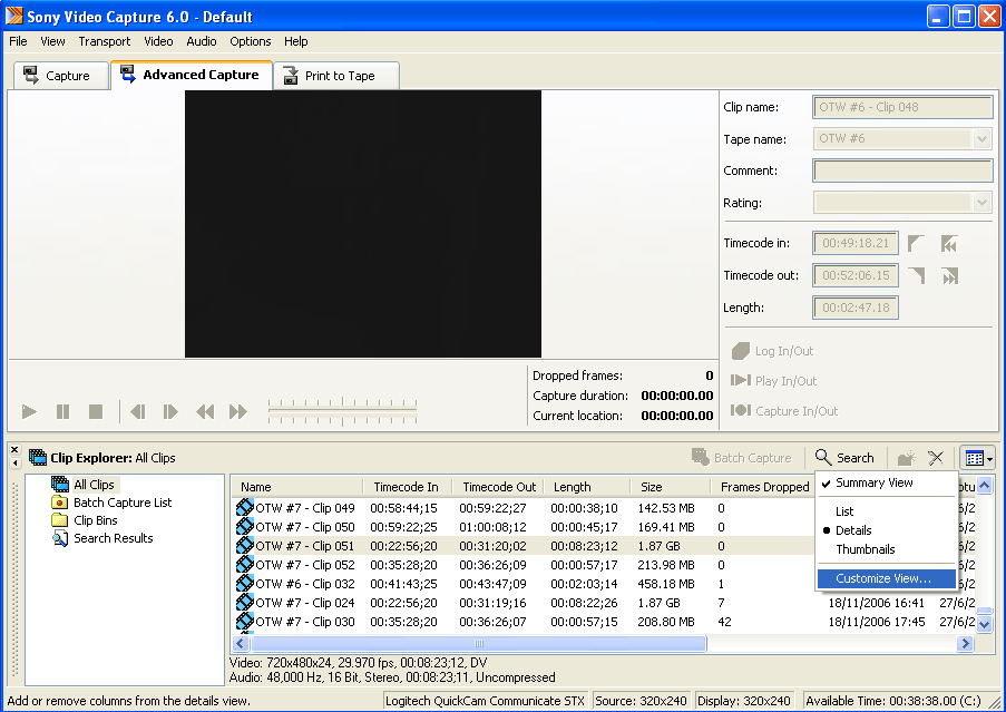

Is there a way to determine which clips have dropped frames in them without watching them all?

I found an easy way! Go to the clip pane in Video Capture and select Customize View... Add Frames Dropped to the current columns.

Is that for HDV or DV? I use HDV Split to capture my HDV, so I don't use Sony's capture utility.

This is for DV, or anything that Vegas' capture utility can understand.
