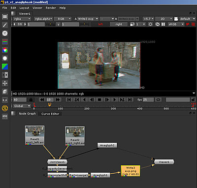

Hi,
the corrected image is the second, for me the second image is more easy to see and work better when there is movement in the scene.
i d'ont know how the plug-in work, but i use the tools "InterocularShifter" and "ReConverge" to obtain this result.
see the attached picture:
thanks, Marco Neiva.

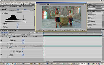

In the process of adjustments/corrections in post in my 3D movie I had several problems with Nuke+Ocula.
1: I don’t have a supercomputer, the algorithms of Ocula need a lot of processing.
2: Nuke doesn’t allow to export for AVI files, only MOV with compression or sequence stills.
The solution was to use the After Effects, this software allow me to do some adjustments and view in live the 3D effect through the anaglyph. In the next days I will put the updated files with some improvements.
thanks, Marco Neiva

Old January 21st, 2009, 09:08 AM   #20
Posts: 4,957
Looks like you have some scaling or rotation issues in that image as the door at the rear of the room looks to be taller in one channel than the other. I find that it is difficult to get the rotational or roll alignment of the cameras perfect on my rigs. The error is most noticeable on wide shots. Fortunately it is a constant error so it's easy to fix in post with a simple adjustment to one channel.
I have a constant 0.5 degree roll error on my new rig, which may not sound like much but when you get strong horizontals such as the horizon or bricks the error really upsets the way the image fuses, more so than a slight scale error or excessive separation.

Hi,
yes is true, the door at the rear of the room looks to be taller in one channel than the other, i think this is a issue caused by keystoning distortion, in my shots i used always convergence.
in this link explains this big problem:
RMM 3D Encyclopedia - Keystone / Convergence error
thanks, Marco Neiva - HyperCube Produções 3D.

I don't think it's keystoning as it's not apparent in the corrected images you posted earlier. It just looks like a simple alignment error. Any keystone errors with a pair of close spaced side by side EX1's at that kind of distance would be minimal.

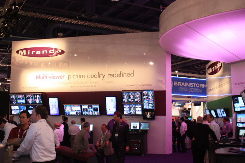

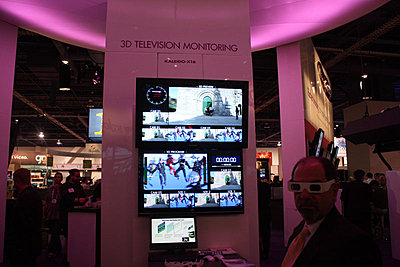

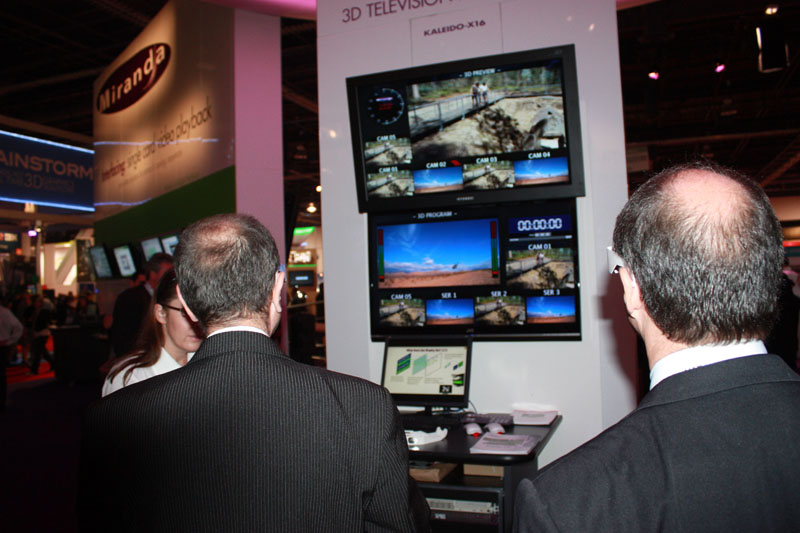

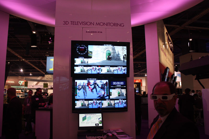

"Maravilhas 3D" NAB Show 2009
Hi all,
this year the NAB Show 2009 breathes 3D, and my 3d movie "Viagem às Maravilhas de Barcelos 3D" it is in exhibition.
the Miranda Technologies is using my movie (and others like Skydiving Footage from Eric Deren - seen in the pictures) to demonstrate their 3D products, like "Kaleido-X16" and "stereo pair of JPEG2000 based media player".
thanks, Marco Neiva
