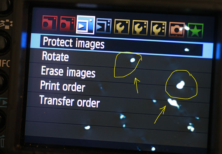

I took my new Zacuto and 5d Mk11 for a field test to a cycling event the other day, bright sunshine.
I had also attached a pistol grip that fitted to the left hand. Holding the grip at rest with the left hand, the lens pointed to the ground. That meant that the Zacuto pointed at the sky and at times the SUN !!
You can see from the attached pic what this has done to my LCD ... burnt it, leaving milky white spots and streaks. It is obvious to me now, but I think that these devices should come with a simple warning.
Does anyone know if this is reversible, other then a new LCD?

Boy that's pretty sensitive considering you would be moving your arm around a fair bit.

You need a new LCD. Happened to my Sony EX1 with a different magnifier two times. Out in the sun with any magnifier on a LCD it only takes less than a second for this to happen, like frying ants with a magnifier, only this is going to cost you!
See My EX1 LCD blog post, same appearance as your LCD.
How to Replace Your EX1?s LCD

Reminds me of this: EVF Sunburn & Scorched EVF Return Procedure by Don Palomaki and The Watchdog

Wow, that sucks, sorry to hear about your troubles.
This probably isn't going to help you, but the 5D2 actually has a protective screen in front of the actual LCD. Many people don't realize this, but it might be that you only fried the protective screen. Somehow I kind of doubt it, but if true, replacing the protective screen is simple and cheap, so here's to hoping that's all that happened...

I just noticed this on my 5D MK II LCD. I'm not sure when it occured but I also use the Z-finder. I have one white spot at the bottom of the LCD screen.
