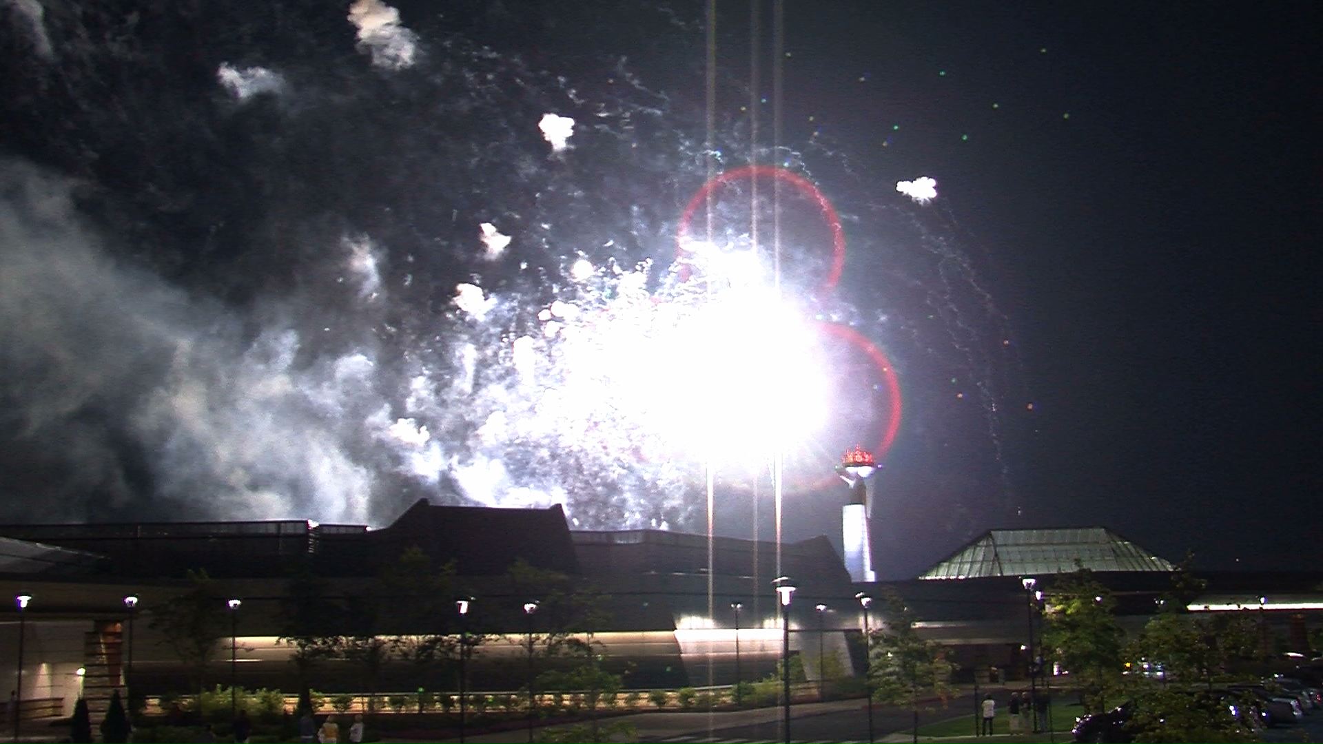

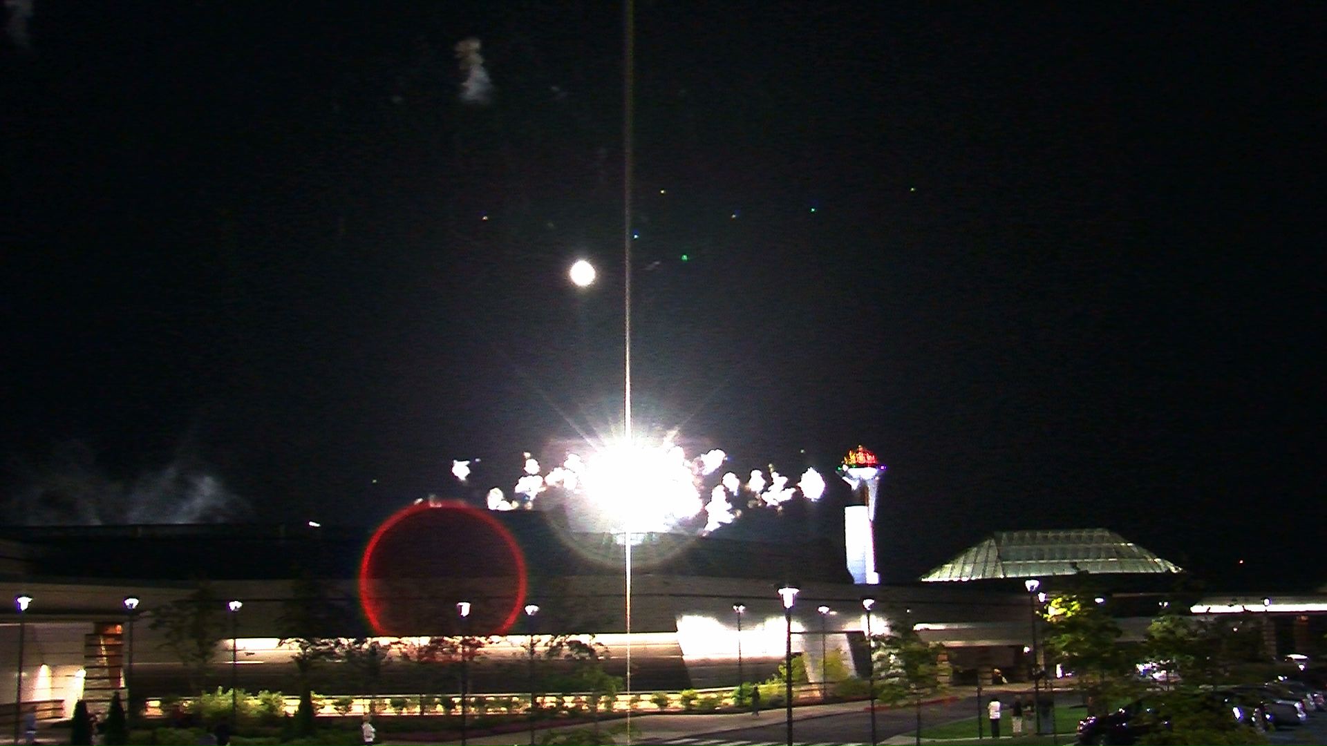

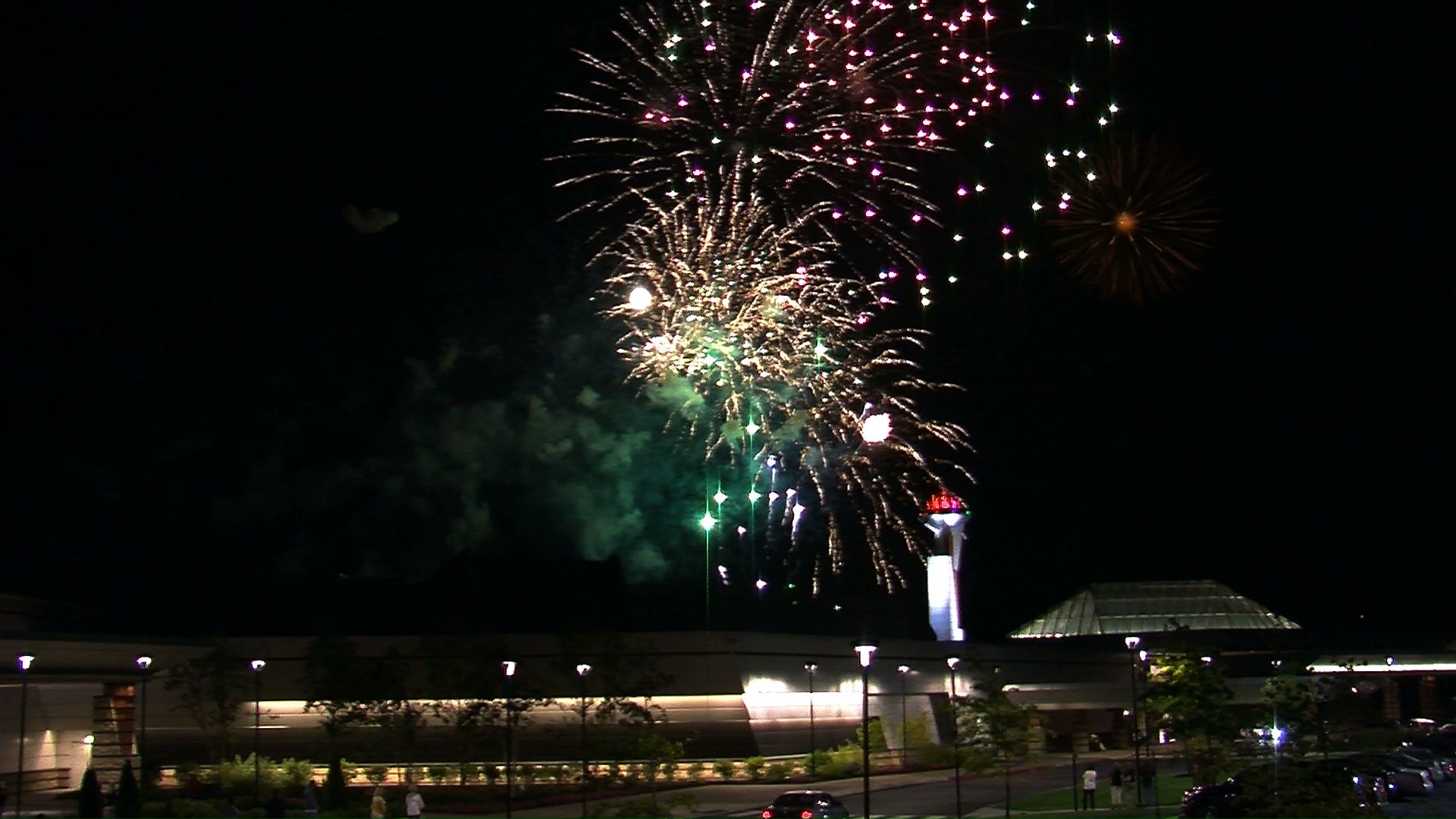

I'm in the middle of doing a review of the HM100 and I'm sure most are aware of the vertical smear issue. It's very prevalent in a fireworks display as well as the flare associated with it. It's almost unusable for fireworks displays. The burst is exaggerated white circles with extreme vertical extensions. Here are some examples.
Vertical smear in fireworks display-000_0126_01.jpeg   Vertical smear in fireworks display-smear-2.jpeg

The white circles are in the lens, the vertical smears are in the CCDs. Extreme light will cause some form of smear on all chip pick-up devices, CCD or CMOS. It's a reaction to having too much energy from the light and the sensors are unable to distribute it correctly. The larger the chip's physical size the less smear. Expensive HD camera rarely have this problem as the light source would have to be unusually bright to cause the problem. Turning the light sensitivity up will increase the smear.
Quite frankly, while the smears on your stills are bad they are a lot better than what you would have gotten a decade ago.

I rented a Panasonic HMC150 with CCD's this July 4th. I used many different manual exposure settings and I got very similar results as you did. I finally got some good shots by lowering the exposure (f6.5, or f8, fast shutter, little or no gain) to get it to look good.

The vertical smear on CCD sensors is due to excessive light spilling into successive columns as they are read out. As Ben says, better cameras don't exhibit this problem. Mine certainly doesn't (PDW-F350).
It's not the arrangement of the pixels, but how they're read out of the chip that makes CMOS less prone to vertical smear.
Andy's tip is a solid one, in that you should stop down because the fireworks are much brighter than you think. In your screen shots, your brights are very blown out. Not to mention, you'll likely be at a long distance and zooming in will give you a shallower depth of field if you open the iris up. Stopping down helps keep all the fireworks in focus since they won't all be at the same distance from your camera.

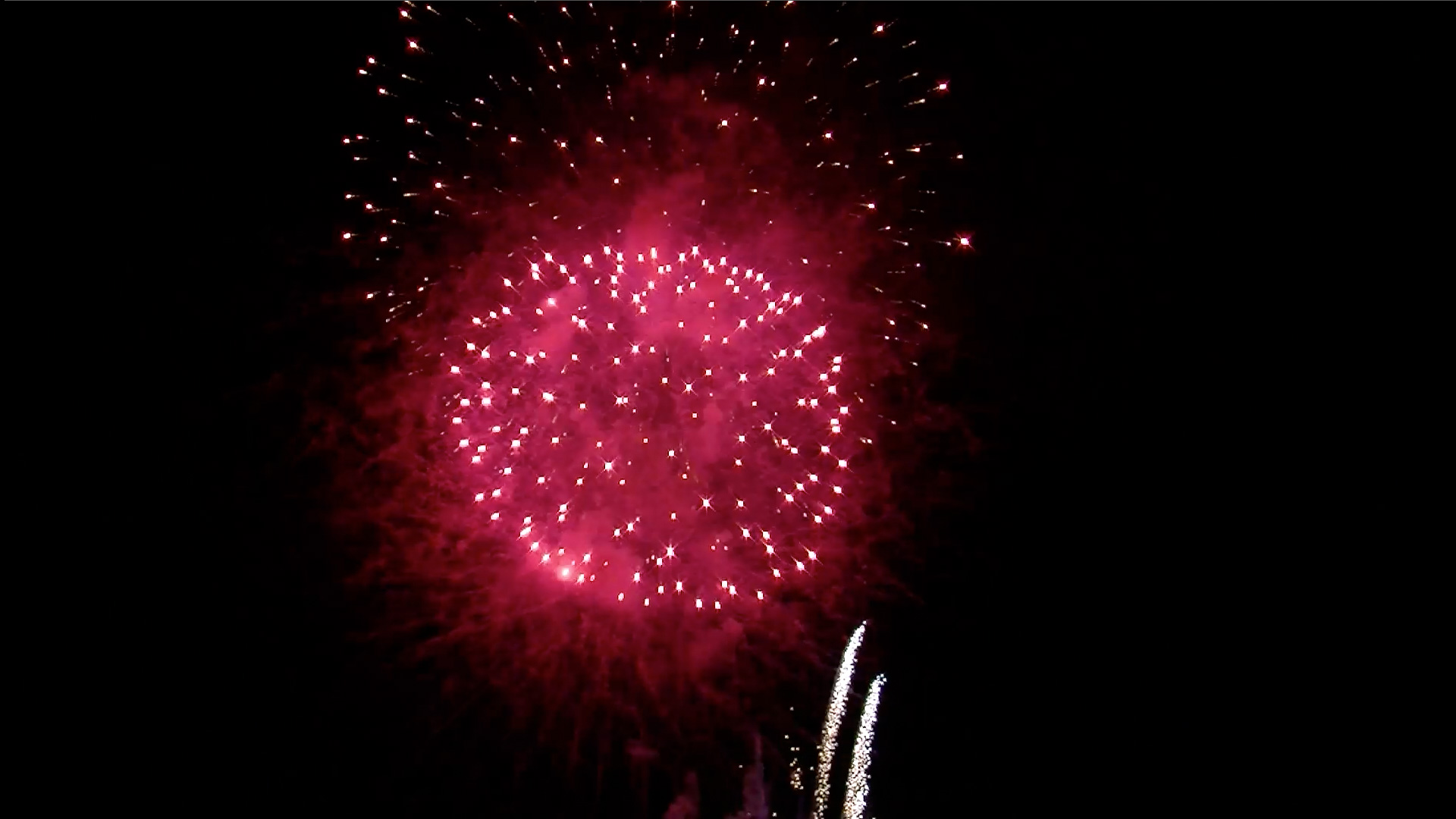

did some test shooting 2 weeks ago...
....like Andy said: lowering the exposure + no gain helped a lot.
Jurgen Schubert is offline   Reply With Quote

Jurgen, that is about as good as it gets. Well done on the fireworks shot!
