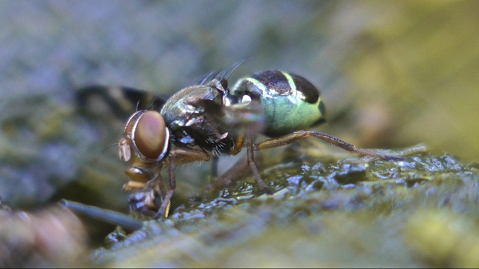

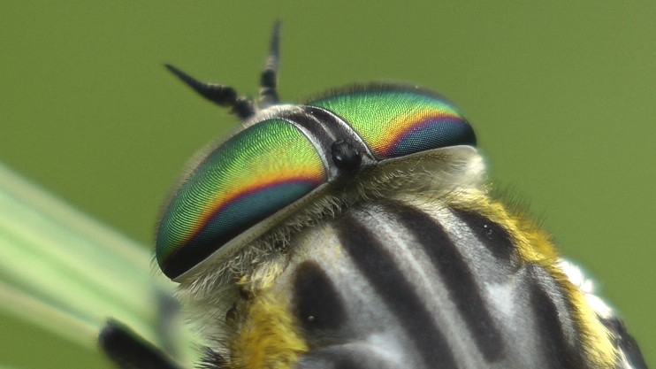

TM 900 aperture control - an observation
I have an interest in close-up work and often use a Canon 250D close-up lens on my TM 900 for this purpose. Depth of field is very limited as one would expect at a working distance of about 20 cm at 20x zoom but until today I have never tried to measure it. I had always assumed that stopping down actually did something useful.
My test was to set the camera to view along a ruler and measure the depth of field at different apertures. Irrespective of the aperture shown the depth of field using the TM900 was always about 2 mm. On the other hand using an EX3 with a Micro Nikkor the depth of field was very dependent on aperture as one would expect.
Two TM 900 video frames are shown below. The depth of field of the fly feasting on the wallaby dropping is so low the wings cannot be seen.

Old May 1st, 2012, 05:59 PM   #666
Location: Melbourne Australia
Posts: 626
Re: The Panasonic TM900 Users Thread
I meant to add to my post above that if my observation is valid it suggests that there is no iris control in the TM 900.

That seems an odd thing to put in print under your name Alastair, when the operating iris blades are visible to the human eye.

Quote:- "If my observation is valid it suggests that there is no iris control in the TM 900".
I have repeated my experiment with very different results. In my first test the smallest aperture reading I could achieve was f11. In my most recent tests the minimum aperture reading was f16. Furthermore I was getting a very measurable increase in depth of field with decreasing aperture. Between the two sets if tests I had tried some exposure duration tests. These involved setting my TM 900 up on the bed of my lathe so that it could record the equivalent of fast turning clock hand while varying the exposure time. During the exposure duration tests the camera was subjected to some vibration and afterwards it worked as I had hoped it would. I am wondering if the vibrations have been responsible for the apparent change.
