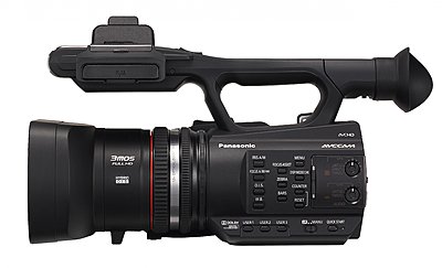

Forgive me if this is old news to you - but have you seen whats coming?
Panasonic introduces AG-AC90 AVCCAM HD handheld camcorder | ENG content from Broadcast Engineering
Other then 1080 60p one of the best parts of this camera is that it does what Canon did and went the 2.1 mega pixel route in order to do NATIVE pixel for pixel 1920x1080 acquisition - it should be great in low light.
http://provideocoalition.com/index.p...d_sd_image_ca/

Thank you, Clayton. I can't believe how good that AC90 looks! Almost certainly the camera for my sports needs.
No built-in mic, but that's okay.
Can you tell if there is an LANC port?
I'm sure glad I procrastinated on my purchase... and that you thought to lay that one on us. Thanks again.

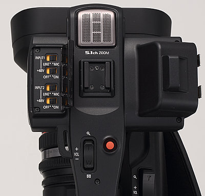

Old September 14th, 2012, 08:29 AM   #784
Join Date: Feb 2004
Location: Sacramento, Ca.
Posts: 70
Re: The Panasonic TM900 Users Thread

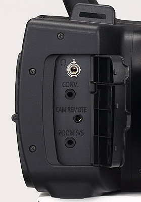

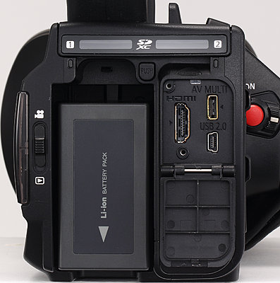

"The AC90 includes such desirable professional features as time code/UB recording; time/date stamp, and two wired remote control terminals (for zoom, focus, iris, REC start/stop controls). "
It has a built in mic that works like the TM900 switchable between 5:1 and Stereo.
VariZoom Panasonic Lens Controls | Control Zoom, Focus, and Iris
The Panasonic TM900 Users Thread-ag-ac90_03_rside_connector.jpg   The Panasonic TM900 Users Thread-ag-ac90_04_top_audio.jpg
The Panasonic TM900 Users Thread-ag-ac90_05_rear_connector.jpg   The Panasonic TM900 Users Thread-ag-ac90_01_lside_original.jpg

Enticing camera. Almost everything you get with the ac130 but smaller sensor, less reach.
2 ports for remote . . . are Panny's not LANC compatible?
Mark Ahrens

LANC is a SONY Remote protocol implementation called Control-L and its bi-directional
Panasonic uses "Control-M" a similar 5 pin bi-directional protocol but implemented differently.
Some controllers like this one are switchable.
Manfrotto MVR901ECPL Lanc/Panasonic Clamp-On Zoom MVR901ECPL B&H
and
http://www.bhphotovideo.com/c/product/361366-REG/Libec_ZC_3DV.html
Clayton Moore is offline   Reply With Quote

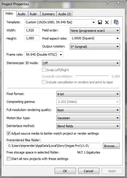

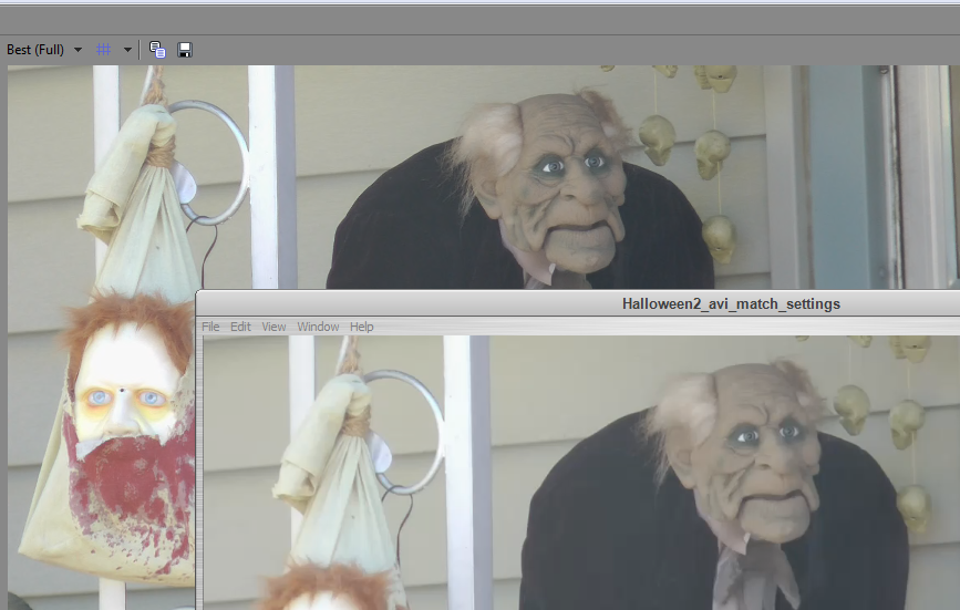

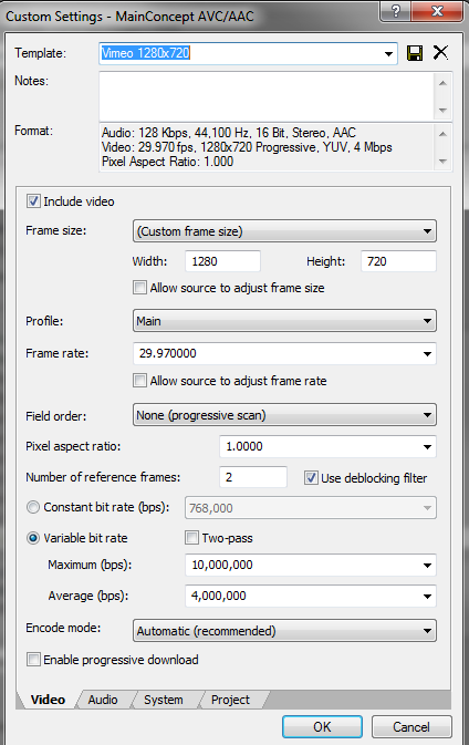

I'm having a problem with image quality loss when rendering files from the TM900 to .MP4 using Sony Vegas Pro 11. The attached files show the project settings used, the rendering settings, and the output. The original video image (top) and the rendered image (bottom).
Does anyone have advice for what settings to change so that the image quality is retained better?
My workflow is to take the MTS file and convert it to .AVI with Cineform and then edit the .AVI file in sony vegas pro and output to .MP4 at 1280x720p. The original file is 1080/60p.
