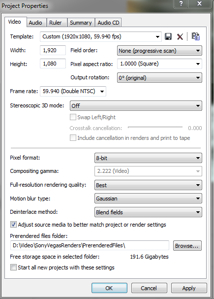

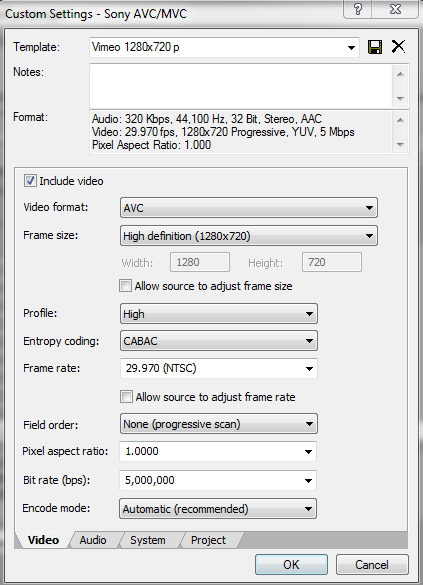

Riki, Here is the workflow i use with TM900 footage (i shoot 1080 60p) and Sony Vegas Pro 11:
1) Transcode the MTS files to AVI using Cineform. You can get a free copy of the software at GoPro.com
2) Open Vegas project with settings in attached image
3) Add AVI files to Vegas project. (AVI files will allow for smooth playback during editing)
4) Edit (disable smart re-sample on all clips)
5) Render with settings in attached image.
6) When you are finished with project editing, you can delete AVI files to save space. DO NOT delete the MTS files.

Thanks Mike for your reply. One question, my camera is a European model so I have shot on 1080-50p. Do I choose 1920*1080-50p (Double Pal) in Vegas. Any other settings to change ? Also forgive my ignorance , but Cineform Import does not see the .mts files, maybe I am doing something wrong.

Riki, Yes match your footage (50p) for the project settings and for rendering use 25 in place of 29.97 that i have.
I don't know if there are any other changes needed.
