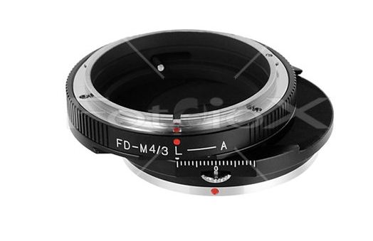

Old March 12th, 2011, 09:07 AM   #51
Location: Cincinnati, OH
Posts: 8,425
Re: GH2 footage doesn't look as good as my old camera, why?
What is the dial on the adapter for?

Old March 12th, 2011, 01:27 PM   #52
Posts: 3,531
I have a different FD to MFT adaptor where the rotating ring is labelled Open/Lock. This operates very nicely as a smooth step-less aperture ring. There is a little pin on the adaptor that operates a lever on the lens to adjust the aperture.
