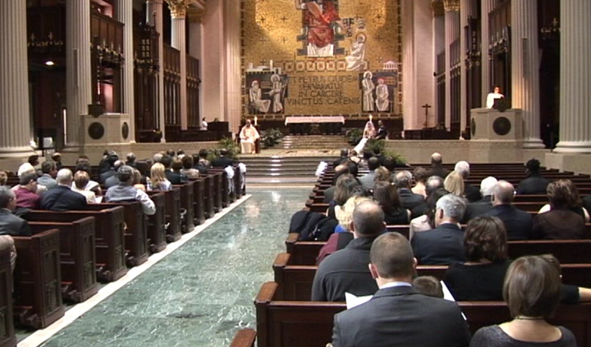

I shoot in dark spaces, gothic or greek revival styled styled buildings where lighting is an afterthought. 1.7 is pushing it, as I mentioned earlier.
1.7 is pretty good relatively speakiing, but you also have to keep in mind I'm also outfitting two GH1s. ISO on those above 200 produces very poor images, at least in my preliminary tests.
Some churches here built in the 1840s are exceedlingly dark. They don't care about lighting. Unfortunately, I do not shoot as often in modern, well lit protestant venues.
Getting closeups in these environments is difficult.
For some women in Cincinnati, a ceremony at St Xavier or St Peter's here is a lifelong dream, and this is a huge deal to them. Brides here sometimes/often want the biggest church, and longest aisle. This tranlates into dark and far to you and I.
David, if you're using a Canon FD 1.8 successfully, then imagine a 1.4.
Covenant Presbyterian church here is so dark it is beyond belief. I used the FX1000s which are quite decent in low light, and the results were pretty poor there. I've also shot in that church with the PD170 and VX2100, still the kings of affordable low light video, IMO, and it was still pretty bad.
Realistically, the results were fine, and I understand that. But from a customer's perspective, they were disappointing. When you can't get a decent closeup of a ring exchange because there isn't enough light, you have trouble.

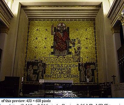

The images below are from a typical Catholic church here, the 175 year old St Peter's in Chains cathedral, a sought-after venue for many catholic brides in this area. The FX1 shot is from LESS than halfway to the rear. I'm closer to the front than I am to the back. Try getting a closeup in that light with a 4.0. Will a high ISO compensate in this case? It will help, but I don't know. I was lucky in this case, because the church was not half full and I could get close.
The smaller photo is actually taken from the church's website.
