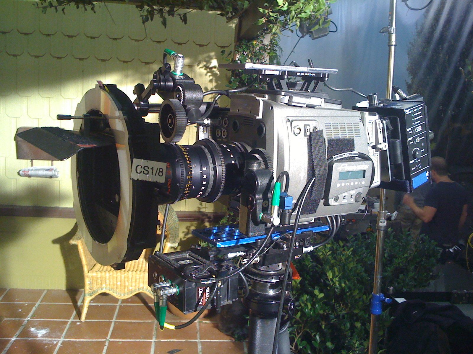

I've had one for a couple of years that I occasionally use onboard my Steadicam as an eyelight--I've replaced the knob with a little 32 pitch gear and mount a Preston motor to it, then hand the remote iris to the DP so he can feather the output as needed. In this application, it's never the primary exposure so it's OK that the level is a little down especially when corrected down to 3200. I've been thinking about trying the Zylight 90 as a more flexible option, especially since the Zylight guys have offered to make me a custom one that dims all the way to 0 (the standard model does not) which is critical when passing by reflective surfaces. However I'm a little underwhelmed by the current softbox attachment (Chimera and speedring, a bit clunky) and would like to see something a bit more custom.
FYI I used an interesting product called the Kisslite from Gecko; it's a small LED ring light with integrated filter trays and eyebrow. You can switch the LED clusters on or off in quadrants, plus dim the whole works and all of this locally or remotely. It comes with both 3200 and 5600 modules and can be field swapped quickly. It's not cheap but it fulfilled a need. We used it full-time on the recent ABC series "In the Motherhood".
