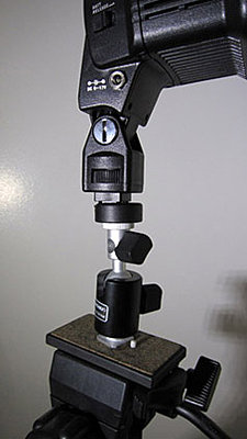

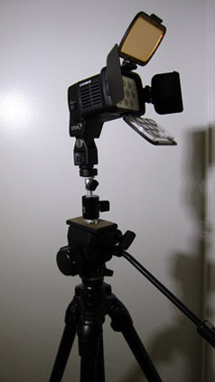

Another good thing for the Comer lights (other than the 1800lux Comer output compared to 1200lux Sony output), it takes third party batteries. Sony lights only work with Sony batteries. That's a rip off.
The light can also be mounted on tripod to be used off the camera. It's a good investment I would say. I am selling it but I am also using them wedding events. It is very useful and powerful. Not just regular on-camera light that casts a soft circle to the scene.

Michael, glad you like the comer light. At the bottom of the light mount, there is a thread hole you can mount the light on any camera tripod too. Or you can get some mounting accessories
Tripod Mount and Desktop stand
