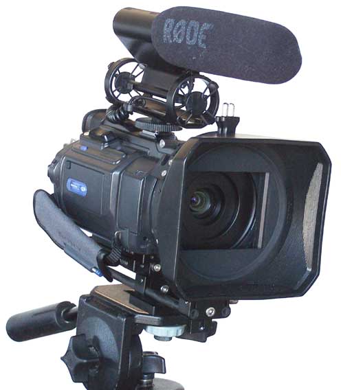

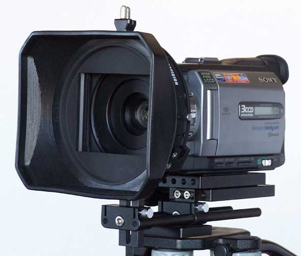

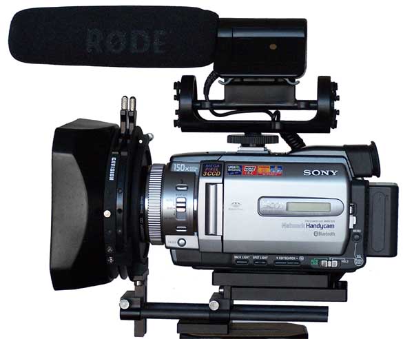

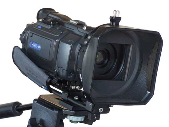

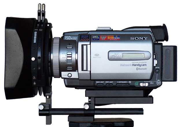

Pics of my Mattebox setup
Finally able to take some images of my TRV950 with Cavision 3x3 Mattebox and 8mm rails setup.
My setup includes 37-58 (standard) & 43-58mm (Century Optics .55 w/a lens) step up rings. When I originally got the mattebox and rails, the center line of the camera was something 3-5 mm off with the maxed out adjustments made - Jason at Cavision suggested a second baseplate to use as a spacer and it works perfect as you can see in these images.
Anyone looking for a mattebox for their TRV950 or PDX10 - I highly recommend this setup. I am using my Cokin P series filters in this as well and can't wait to finally shoot some serious outdoor work now with my grads.
Total cost - Approx $275.00 for everything
Pics below:
TRV950 -- various questions-trv950_cavision1.jpg   TRV950 -- various questions-trv950_cavision2.jpg
TRV950 -- various questions-trv950_cavision3.jpg   TRV950 -- various questions-trv950_cavision4.jpg
TRV950 -- various questions-trv950_cavision5.jpg   TRV950 -- various questions-trv950_cavision6.jpg

Old April 6th, 2007, 02:20 PM   #190
Join Date: Dec 2002
Location: Mays Landing, NJ
Posts: 11,826
Very cool setup! And wow, how did you get all that stuff for under $300? :-)

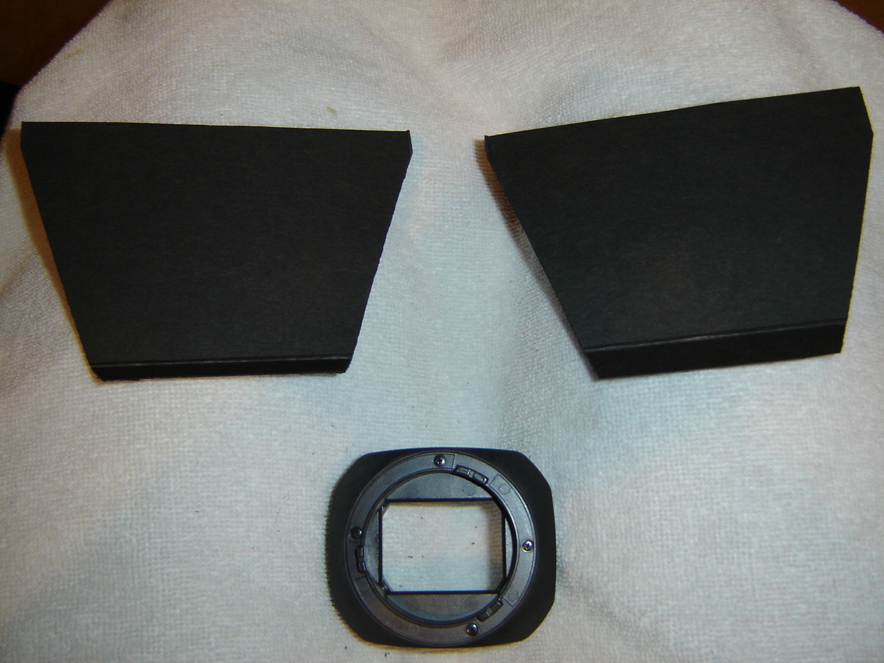

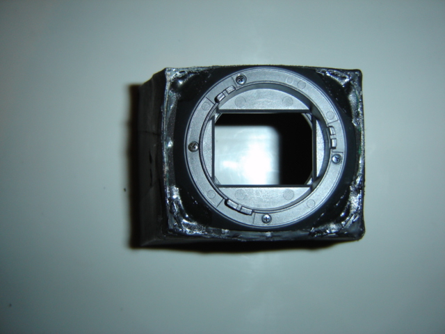

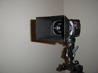

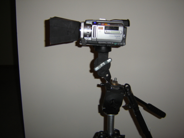

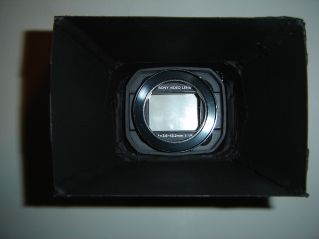

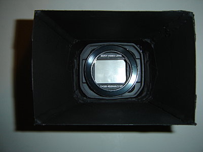

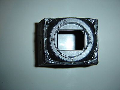

Hi Cliff,
I took a slightly different aproach.
I took a 49 to 58 Step-up Ring and used silcone glue to mount it to the front of the OEM Lens Hood. That allows all my 58 filters to be mounted.
I then made an Extended Lens hood out of old black VHS hard case plastic, and silicon gluded it to the OEM Lens Hood.
Cheap, easy, and works if all you need to use is round filters.
Pics below.
Harold
TRV950 -- various questions-lens-hood-009.jpg   TRV950 -- various questions-lens-hood-026.jpg
TRV950 -- various questions-lens-hood-22.jpg   TRV950 -- various questions-lens-hood-028.jpg
I purchased the rails and mattebox from B&H (I tried to find them from a dvinfo sponsor first)
Cavision RS-816 8mm Light Weight Rod Support
Cavision MB385P 3x3 Matte Box
I had to purchase the extra mounting plate direct from Jason at Cavision - cost an extra $45.00 with shipping.
I was a little off on my total outlay - it is just shy of $300.00
Needless to say, the ability to use my Cokin P Series grad filters and will soon be purchasing a square polarizer from Cavision ($45.00 USD) is very sweet. I am very happy with how this looks and works while shooting.
