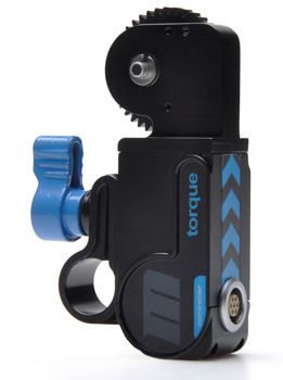

Off topic a bit, but
Just got this the other day with this text;
"Redrock Torque Motors Have Arrived"
"Introducing the Redrock Torque motors: no-compromise strength, ultra-compact design, and amazingly priced. These motors deliver the power needed to move cinema lenses, and the finesse required to focus still lenses. The Torque motors are amazingly compact and give you the freedom to place motors in more places, on more rigs and with more cameras than ever before. The microRemote system maintains compatibility with Heden digital motors for those that have already purchased Heden or want to stay with that brand. Heden are fantastic motors and we love working with them. Redrock Torque motors provide a powerful, economical option for digital motors."
Do you think it will work with your new motorization bracket? Looks to be a substantially reduced price from Heden/Preston/ type of systems. And how is that Today FIZ system coming along?
Works in conjunction with the Redrock Micro Remote system
Redrock Micro - microRemoteUpdate Page
No word on final release date, but soon I'm told.
