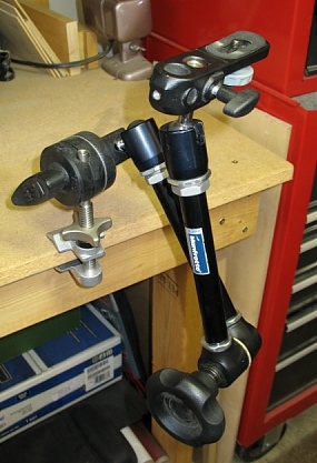

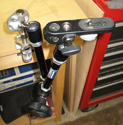

Wow, 3" is a pretty big pipe. You could use a Matthews Big Ben Clamp (http://msegrip.com/mse.php?show=prod...ducts_ID=24108) and then clamp the Super Clamp to the 1-1/8" pin. Or you could use one of the 3-series Cardellini Clamps (http://www.cardelliniclamp.com/clamps.htm). Those have a 5/8" pin on the end. The Magic Arm also has a 5/8" pin on the end. Matthews sells that Vise-Grip chain clamp with two studs so I'm assuming it would work. Just be careful about using the stud that's on the end of the handle like they say.
The trick then is how do you connect two 5/8" pins together? I guess you could use a Hollywood Head (http://www.msegrip.com/mse.php?show=...ducts_ID=25058) or a Cardellini Card-A-Link. But again, I'm not a pro grip so you might want to consult a professional rigger. And again, safety cable the camera and the rig.
Here are some photos of my magic arm with a Cardellini Mini Clamp and Matthews minigrip head. Also, the magic arm with a Card-A-Link.
Camera mounts/ rigging for rock band shoot-magic-arm-griphead.jpg   Camera mounts/ rigging for rock band shoot-magic-arm-swivel.jpg
