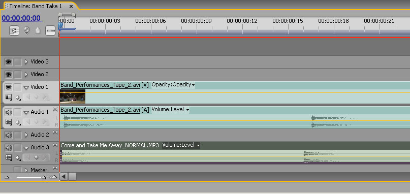

Thanks for the help guys. I have uploaded a jpeg of the timeline. As you can see it's zoomed all the way in and as Yossi mentioned, it's snapping to the nearest fame. The project is in 24p (music video) and I am trying to line up the audio track with the exact same audio queue that was on the video shoot. They are off by like 1/2 a frame as you can see. is there any way around this do you know?
Ok, this is clearer, this is how it should work; In the timeline window menu (in the right upper corner, very small arrow) select "audio units" and turn off "snapping" on the time line (you can toggle that using "s" on the keyboard)
The timeruler now counts the audio samples instead of videoframes.
Zoom in completely again and you will see that you can drag the audio clip much more accurately.
To change the timeruler back to videoframes again just deselect "audio units" in the time line window menu.

Noa ~ This is precisely what I was looking for. THANK YOU - I have been trying to find an answer to this all night :) - you saved me a lot of trouble, thanks so much ! Also to the others that posted - changing the timeline to show "Audio Time Units" via the arrow on the right worked like a charm and now I can easily move the audio to the correct placement in the track! - Now I can actually start editing this video :)
