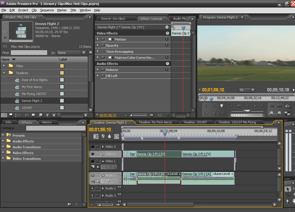

Graham, to be honest, I had to go test it since that is not an option I use. No, the crawls and rolls are not realtime, but to be honest, they really aren't needed. You can easily throw a DVE on the title, set two keyframes and have tons more options. That really to be honest is something I learned and back with the X100. Many people were complaining about realtime title rolls and crawls, when IMO, you have millions of ways to make your titles "pop" more than with a simplistic roll or crawl. I do the majority of my titles in photoshop and import them as layers with all of the blending options and the like if I really want.
So to answer your question, no, it will not do the rolls and crawls in realtime, but to be honest, I don't believe with the X2 they are even needed to be realtime.
I did also set a roll and crawl and compared it to setting a custom roll and crawl the way I mentioned. It took approx 3 minutes to create the simple roll title(maybe because I don't do it this way often, it took that long). No heavy font changes, but just setting it to roll on and off screen. I then had to render it, and for a 5 second title roll, it took approx 1 minute and 20 seconds(just being honest on the specs here). So in total, this title took approx 4 minutes and 20 seconds, give or take a few.
Now, with my workflow, I simply went to File, new Photoshop file, which launched photoshop after naming the file in premiere, I created a title with drop shadow, inner shadown and embossing. This whole process took me 45 seconds. I then simply Cntrl+S to save the file, and voila, it is in premiere! I then dropped it on the timeline, and what? It's realtime! No red render bar... LOL So we are now looking at what? 50 seconds. Now to animate it, since I am using HDV and on my monitor output, I want it in a specific spot, I simply in the effects window typed "DVE", which brought up the Matrox DVE, dropped it on the photoshop file, opened the effects controls tab, set two keyframes for the position(one with the title at the top of the screen, or basically off, and the other, further down the timeline dragging the Y position to off the bottom). There you have it, your title. The keyframing and selecting the DVE process took me all of one minute! And what? It's realtime! LOL So I am at approximately two minutes(I will give this a round up in order to be fair), and the title is ready to go since I am using the DVE. No red render bar, no rendering required. I could shoot an avi now if I really wanted, but this was just an experiment. Another thing I commonly do, is that I like my titles to fade in and out if I am animating them. So I then set four keyframes: two at the beginning of the PSD and two at the end which amps up to 100% opacity and the other two which amp down the opacity. Total time to do this, another minute. Which brings me to 3 minutes for a custom title with roll, drop shadow, opacity changes, embossing, and the like. Furthermore, I can always right click on the title, select "edit original", change the title to my liking in Photoshop, Cntrl+S, go back to premiere and the title is changed, with the flexibility and power of Photoshop. All in realtime! For me, therefore, a rolling or crawling title in realtime is really nothing to be concerned about. It is much faster and does not limit my options.
If you do a lot of titles, I could see this to be honest as a blessing or curse initially, depending on how you work. I am a keyframer, so this is awesome for me. I wasn't up until maybe the X2 I think, when Matrox switched from their older interface to the keyframe interface for effects controls. It really teaches you to work more effectively in After Effects and the like. It truly does become second nature thanks to this one little change that Matrox did. I was really one of those that was reluctant to learning the effects controls this way and to be honest was afraid of keyframes. But once I got a few titles and other effects done in this fashion, I discovered how fast it really does make you and allow you to be. To me, the realtime roll and crawl is the "older" way of working, with a limited number of options for the animating of a title, and then needing to render it. It is easily achieved with more flexibility and "spark" that can be added to your title, by "not" using the roll and crawl option on a matrox system.
With the flexibility of the system, you could also create another photoshop file, leave the title static if you wish, do something like create a bar or some pattern, save the pattern, tab back into Premiere, drop that pattern on the timeline, link the two(title and the pattern), add say a ripple to the pattern,drop a static dve on the two for one of the bottoms of the frame, and you now have an animated lower third! A very simplistic one, but still a lower third.
The other option that is very simple and even faster is to simply create a title in the titler(static), drop this title on the timeline, go back to your effects controls, presets, select dve and you will see tons of animated presets that you can also use for making an animated title even quicker than the photoshop route. This method would probably take you one or two minutes max to do, so your working even faster....
But that is my thought on the realtime rolls and crawls thing...

Yes, I see your point. But in your Scenerio, if I were doing them, to be honest, with my workflow, with the X2, I would actually do a static title and then simply drop a DVE on it that moves from bottom to top(ala star wars) or the opposite, and simply do it in realtime.
And for the "only advantage it would have would be exporting the video to the monitor" with DV, not meaning to be sarcastic, but you obviously haven't used a Matrox X2 or any of their systems. Your speaking in terms of a simplistic I/O card that shoots video in and out of the system and allows for a preview to a monitor, in which the matrox system is not and does much, much more. What it is going to boil down to is not "shouldn't need it on a modern system" but a persons workflow, how much video has to be done and how fast it needs to be done.
Just like you said, you were "told" that the multithreading is right and rendering is much faster. It is a difference between being told and actually knowing for self. What I am basically saying is that rendering is not needed "AT ALL" for the vast majority of what you will do with the X2 system, depending on what your doing.
There in is the difference between the other cards you mentioned which for the most part are simply I/O and not accelerators.
An example, I have a small project that needs to be done by Friday. I still have some shooting to do. With my system, I simply capture, drag the clips to the timeline, drop a few cross dissolves, color corrections, do a little noise correction in Soundbooth, and "THEN" and "THEN ONLY" when I need to export to an avi or any sort of output for authoring or distribution, do I have to "export" the movie. NO TIME DURING WHAT I INDICATED DID I EVER HAVE TO RENDER! For DV that is a huge factor with the amount of video you are able to process. Even with HD in the scenerio I am mentioning, I never have to render as long as I keep my number of layers down. And at the same time, I have complete manipulation control. For example, the screen shot I am attaching, is a simplistic HDV 1080 timeline. Each clip has a color correction on it. Though, you don't see the green render bar above anything. Why? Because I didn't have to render anything to work with the timeline. I also have cross dissolves between each clip. I have a color matte, black video, a title imposed over a matte with a matrox ripple on the actual title(I started playing with the project as I typed this). When I added the matrox ripple I did have to render. The title is 5 seconds long and to render the ripple on HDV resolution took one second and it was good to go. I can manipulate my color correction and the like also without having to render. It depends on what you need to and want to do. But there is no question whether or not the card does indeed make a "huge" difference. Even with DV resolutions.
Heck, even exporting is faster the vast majority of the time, depending on what format your exporting to.
